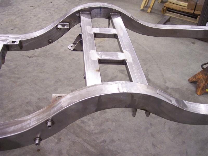

So I can make the rear work, but I have to have this. Don't know if I can fab this up without dimensions....or have to spend the $339.
That front suspension is much like the Heidts and several others. Good article on installation.

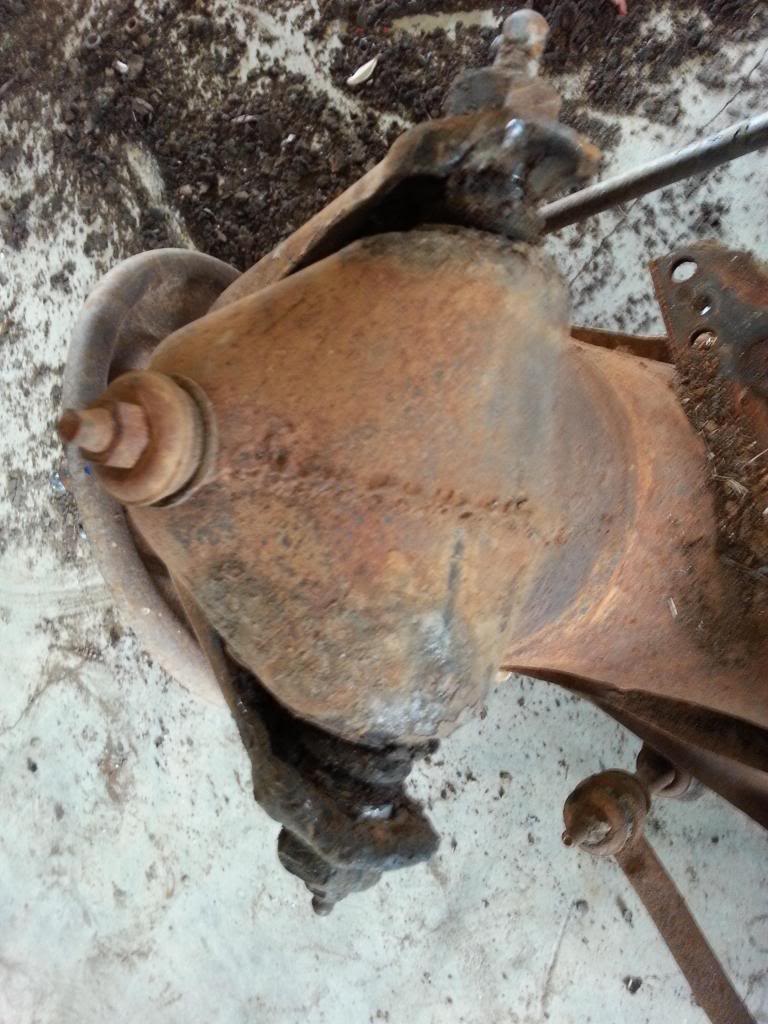

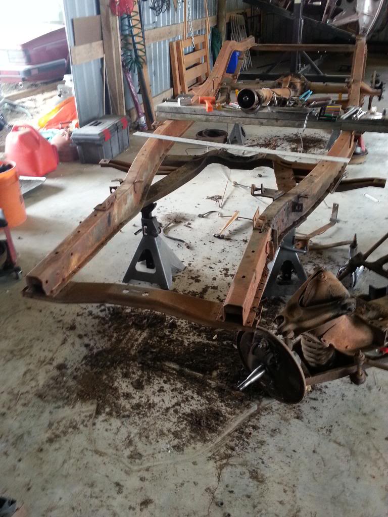

So I removed front and rear suspension from Bel Air. Going to clean up frame t get ready to prime. Leaning toward the Corvette C4 IFS and IRS.
Front control arm bushings pretty worn, and rear leaf bushings nearly non-existent.
