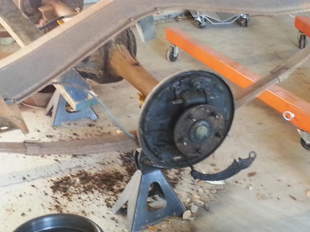

I am considering swapping out the transmission on my 54 Belair. It currently has a torque tube, so I will have to change out rear end as well. I cannot find waht rear end will fit. I was told an S10 rear would work, but it is about 5" too narrow.
Anyone have any suggestions? Dexent forum for this kind of thing? Website that will provide sufficient data for rear ends and such swaps?

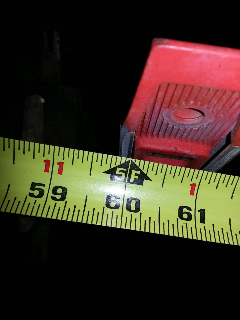

I have sevearl catalogs with Ford 9". But they want a bucket of money for the rear end without gears. And I don't have any experience installing gears. If I could figure out what to look for in a JY or craigslist, I could get happy! Found a S10 for $100, but it is only 54" wide. Am I assuming that to measure you go from face to face on the axles?
Width of current rear end is 59 7/8".

Thanks for the measurements I will start a hunt for what diff you can use, i'll do my best so as you can find a used one. Yes face to face is how most measure it.

Well looks like this would work 59.25 1967-1970 Mustang, Fairlane, Comet, Cougar
Web site that might help you on your way. http://www.carnut.com/specs/rear.html
