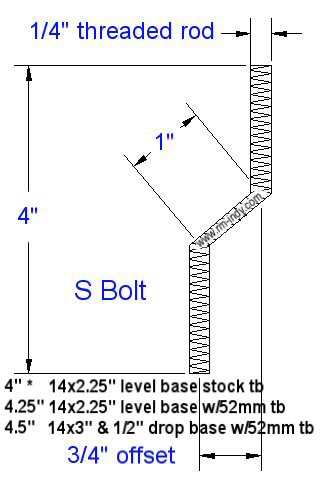

You can make your own, and I have some from a dakota for sale in the classified section.

Ok, I see he asked for an "elbow" and I assumed he meant the bolt. Sorry
But to answer the question, JY. Dakotas and other dodges(durango, jeep ?) use a 90 degree elbow similar to a CAI kit.
