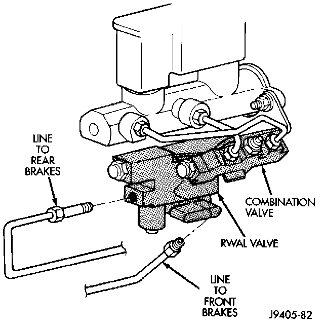

The proportioning valve is built into the master cylinder right?

I don't fully understand brakes, but I don't think it is... That is if it is part of the combination valve which I think it is.

I will have to go loom in the garage tomorrow. I can't remember at the moment.
That doesn't look anything like what is on my truck or the 2500

I'm not sure how much different our brakes are, but that is how mine is. Check this out:
Nope. Its the little aluminum block that both the lines from the master go to first, should have one electrical connection on it. Unless you have RWAL, then it may also have a couple solenoids on it. If you have 4WAL, all bets are off.
