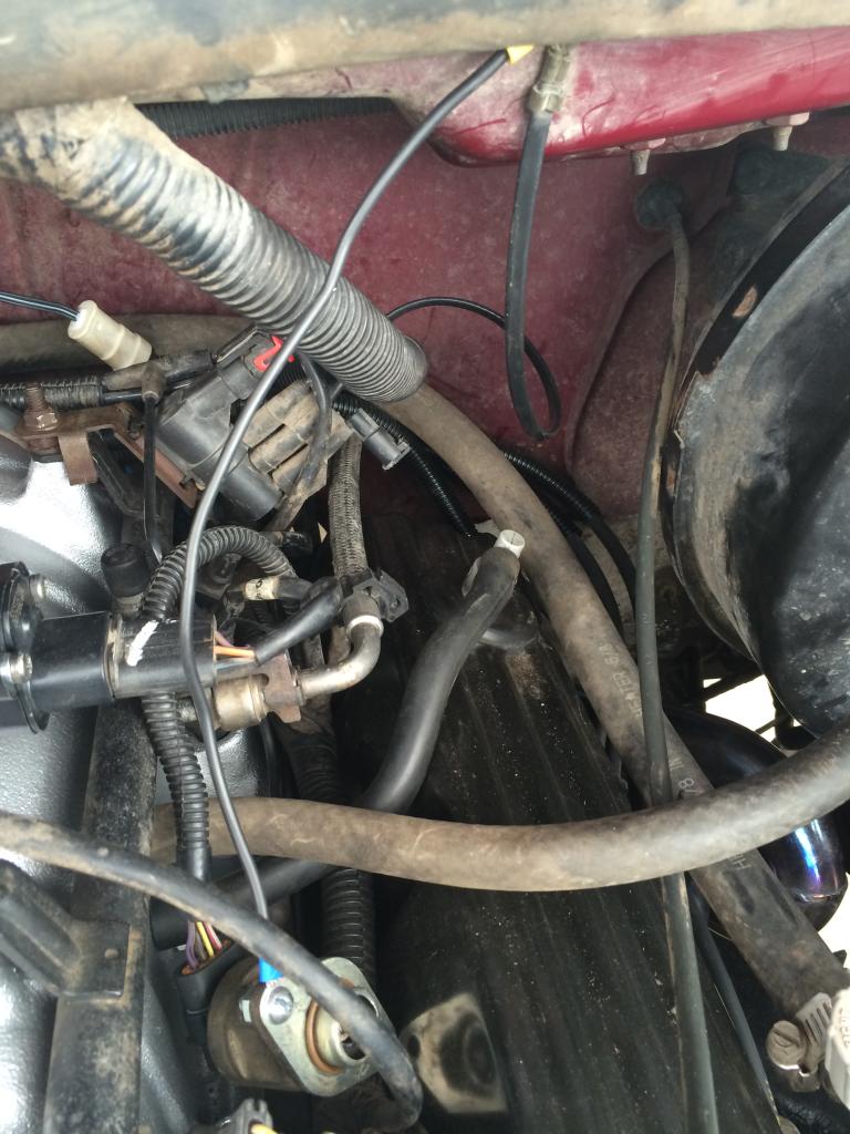

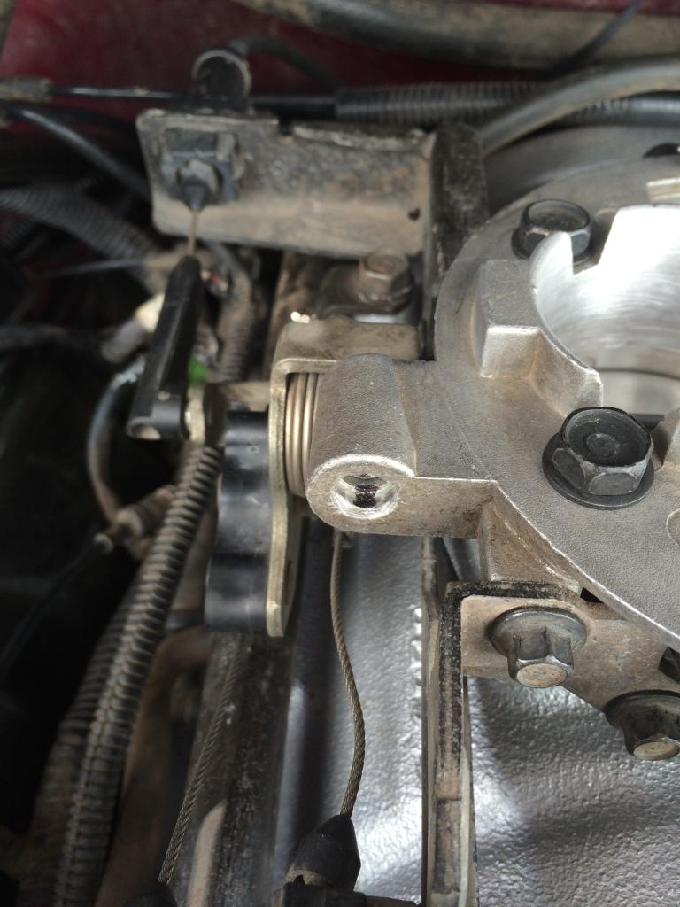

Got my fuel sync set but it still didn't want to idle. Every time I would stop or slow down it would die. I needed to raise the idle so I messed with the stop screw for the throttle blades. That didn't work because the iac would just change position to get the idle back down. So I got rid if the iac and set the idle with the throttle stop screw. I put a iac mostly extended unto the throttle body and I hooked up a dummy iac and a ground for it to make the computer happy. Truck runs great now but at stops in gear it sounds like the motor mounts are bad or something. It's hard to describe but i think the word for it would be it drones haha.

The iac works great. The problem is it's meant to keep the idle lower than I want so no matter how I adjust the throttle blades it adjusts and brings the idle back down. What I need is to change the desired idle rpm in the PCM. I think it can be done with a fancy scanner, if I can get my hands on one, or a b&g custom PCM flash. I'm also looking into aftermarket efi like megasquirt and fast.
