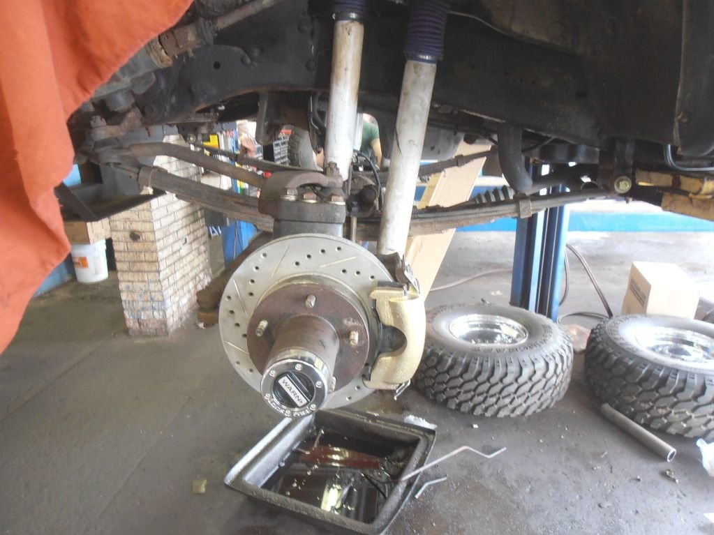

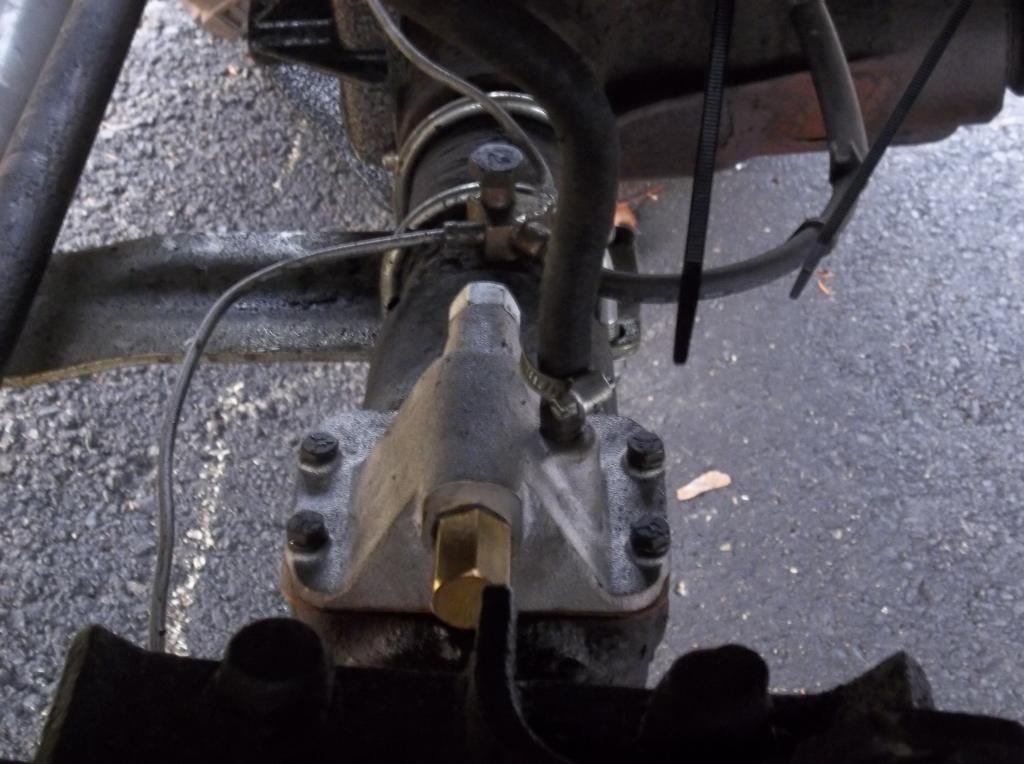

I didn't want to worry about vacuum lines on my truck, and I didn't want to mess with cables. So I installed a Posi-Lock (Perm-Lok) to permanently slide the collar over to lock the inner/outer axles in place. I also changed out the TC's vacuum switch to an electrical switch (very easy swap). Now as soon as I put the TC into 4WD the dash light comes on, and since I no longer have to worry about vacuum lines I know the 4WD is engaged immediately. Here's a little more info (along with the TC 4WD indicator switch part number).

There's also a cable-delete option. Just lock the axle, and cap the Posilock - that's how mine was installed.

I gotta say, my RAM is the first 4x4 I've ever had without Warn locking hubs.
And the one's from the 70's the hubs where aftermarket... stock had nothing... hubs were a fuel savings device.

I got my best mileage ever with a permanently locked front axle.
However, I also went to Dana 60s and 4.10 gears.
I got a solid 14 mpg.

The Jeep YJ's had the same type set up as the Gen 2 Dodge Rams up front (two-piece axle shaft on the long side with a sliding collar). Since 1997 Jeep TJ's have had a one-piece long side axle shaft, and unit bearing hubs instead of the two-piece set-up. So it's essentially the same set-up as putting a Perm-Lok on a Gen 2 long-side axle shaft. I don't know why Dodge didn't figure it out with their Gen 2 4WD truck front ends. When I put my TJ into 4WD I don't have to worry about the vacuum system working and the collar shaft sliding over to lock the two axle shafts into place - when I shift into 4WD it is now into 4WD. And now with the Perm-Lok on my Dodge, I get the same instant response.

There are very few threads about vacuum line problems, moreover they are cheap to replace if need be too. Carrying spare vac line is a no brainer.
The best part of the CAD system though is purposely creating a preferred place of failure under load, all you lead footer out there. Better to have the shift collar fail compared to a axle shaft ujoint or spider gears in the differential case. More costly if the ujoint takes out shaft ears, knuckle, etc.
Great for people to show the options though. I really like the perma-lok one. Least parts of all and the most guaranteed version.
