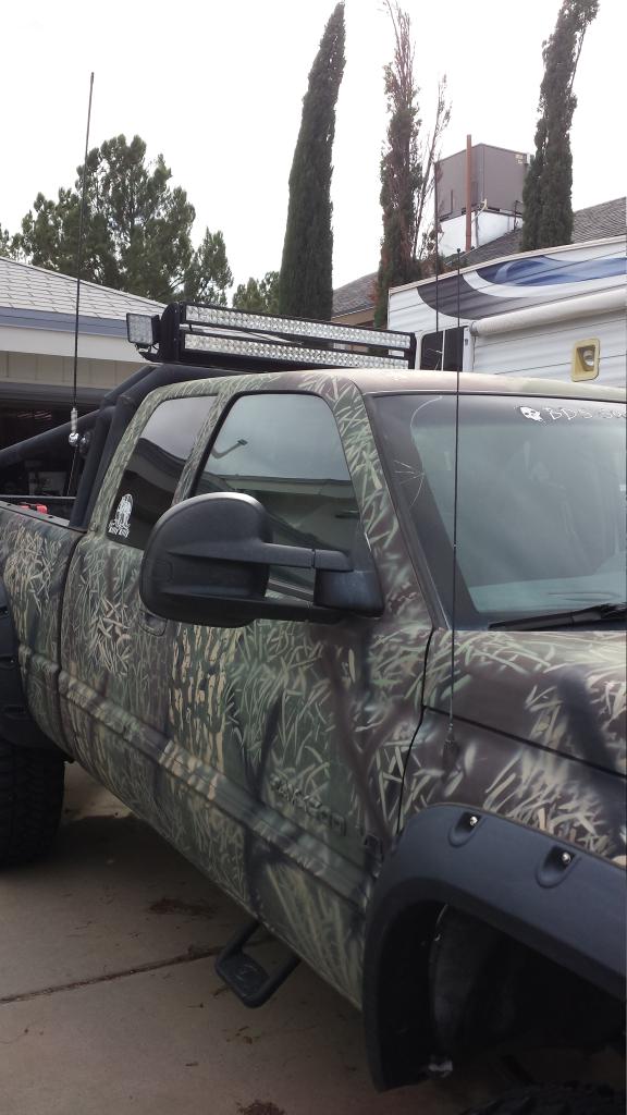

I decided to put a couple of LED light bars on top of the roll bar and take off the PIA's. I fabricated the mount

Here it is installed

Holy smokes, that's a lotta lites. Had a chance to try it out yet? Would love to see pics from the cab, at night.
Also, is your camo painted that way?

Oh man thats gonna be stupid bright! Looks great man!
Haven't tried them out yet, but that will be happening shortly after the steering box issue is straightened out. Maybe Tuesday night I'll get it out for a night run and take some pictures. The camo is painted, I did it last year while the truck was down waiting on the axles.
Thanks, down here in the south west, some of the best wheelin is at night and there is no such thing as too much light.

Nice work! Is the mount on the forward tube of the roll bar or the rear? If able to do on the rear, then you might be able to make the mount such that you can rotate back and down to clear anything? lol Oh wait...no trees out in Texas.

Thanks! When I built the roll bar, four straps were welded between the two tubes for the other lights. I attached the new light bar with four bolts to the four straps, so the bar is between the two 3" tubes.

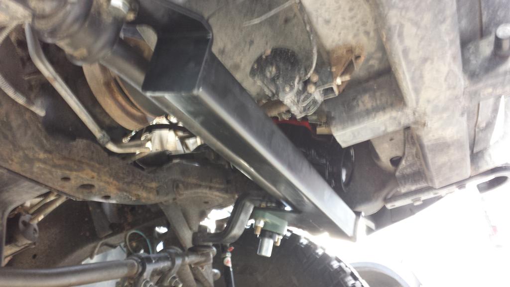

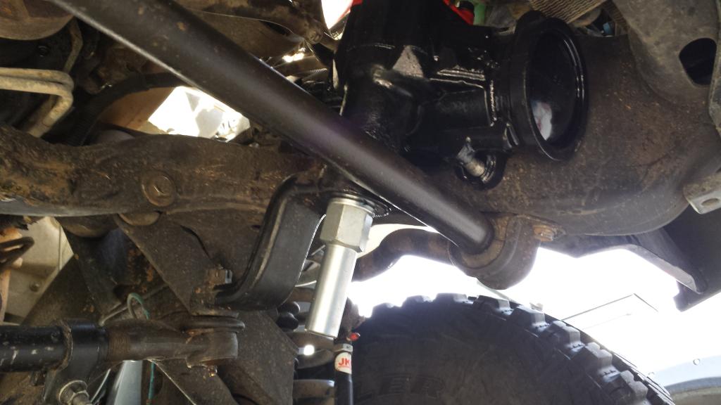

I installed the new gear box and brace

This give you an idea of how the thing goes

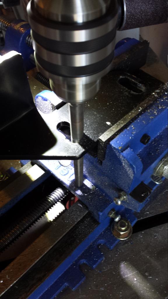

The brace was actually for a 3/4 to 1 ton and I guess the spacing on the frame was a little different so I had to mill out the hole so the hole on the brace would center over the pitman arm
Then got it put up and bolted on. This was actually a two man job but a PITA for one.
I think this should resolve the issues, I guess time will tell
