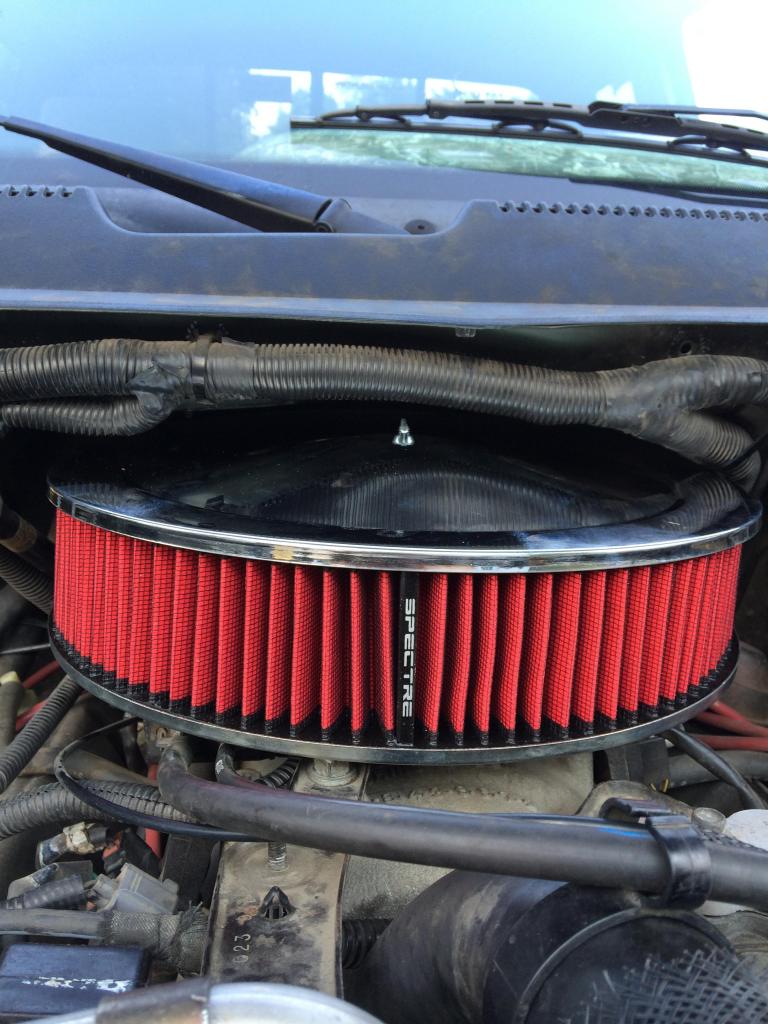

I can't get it in there. I have the spacer on. The bottom sits on top the spacer. The filter will not go in though.
Lines are also in the way.

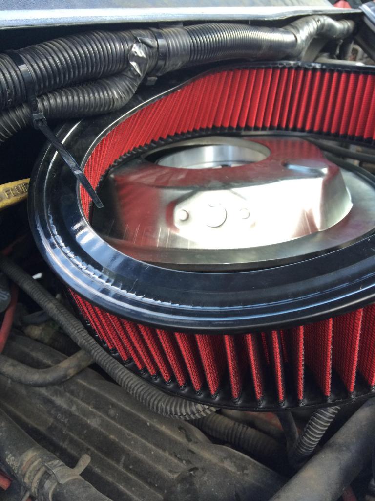

Seems like the body is in the way too when I try and put the filter on.

Got the filter in. Had to take one of the "built in ziptie devices" off. Is it supposed to be this snug?

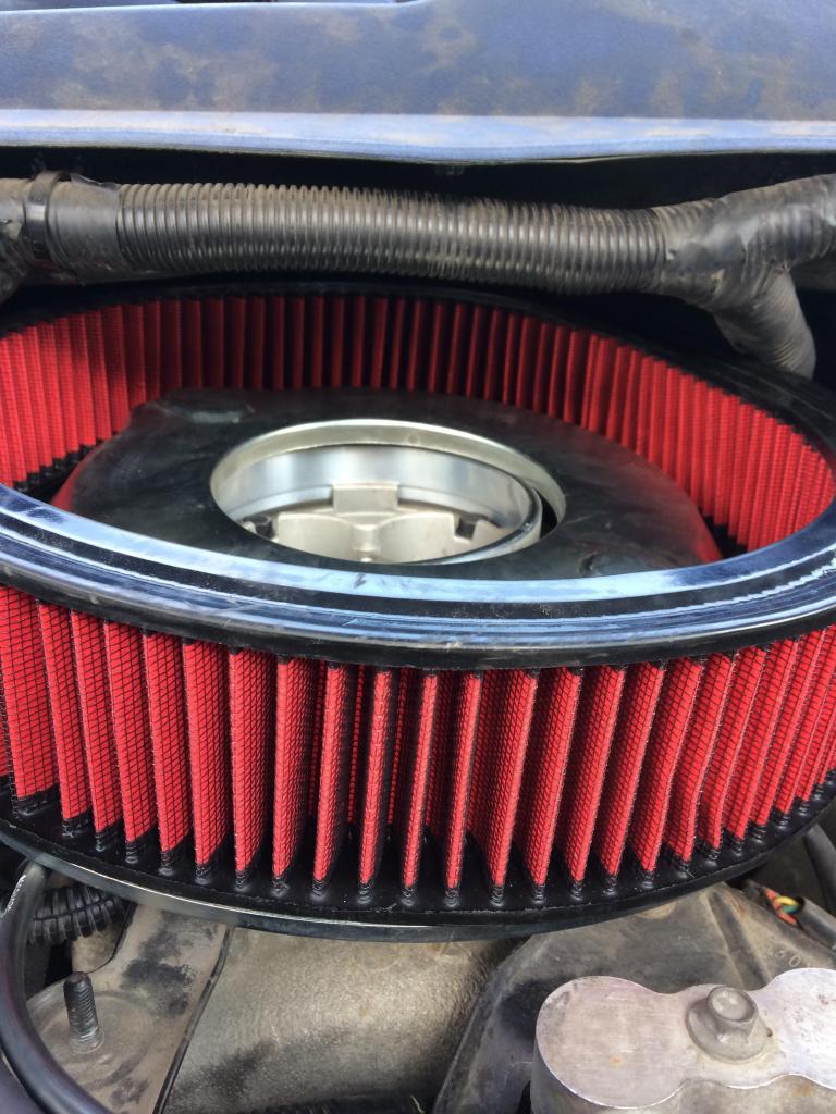

I got it. Pushed the filter in pretty hard. It flexed and went into the pan. It's real snug. I didn't go overkill on the wingnut though. And I'll have a body lift soon.
Someone on the Facebook page said since it's a recessed pan I can lose performance? True?
And is it ok if I don't hook the hose up until I get the little breather filter? I don't have one of those pieces to put in the pan to hook it up to.

Shouldn't hurt anything to leave it unhooked. Not sure how much vapors go through it but it could make a mess. And you need a breather that is for 1.25" hole, not 1". I have this one: http://m.summitracing.com/parts/sum-g3402b
