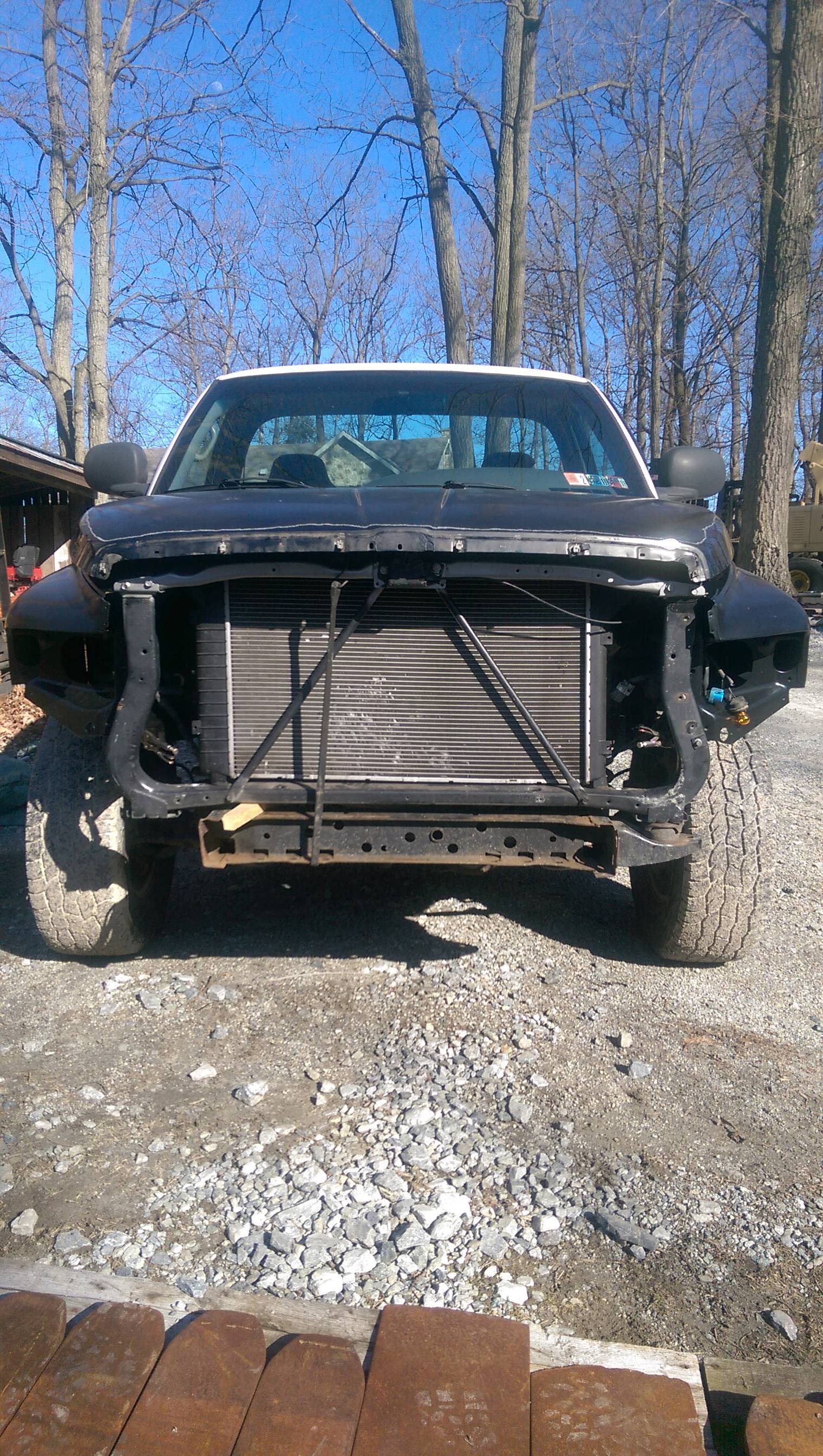

The front of the frame did get bent slightly a half inch to the drivers side so the hood wont line up or even latch. I talked to the guy I got some of my parts from and he has a frame machine that I can pull the frame back that half inch.

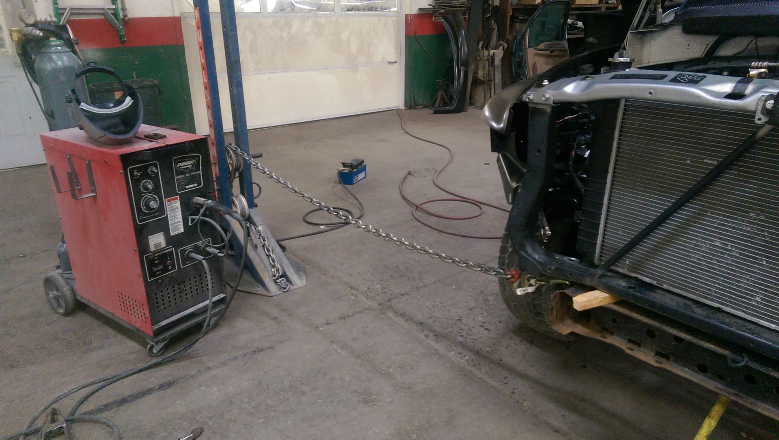

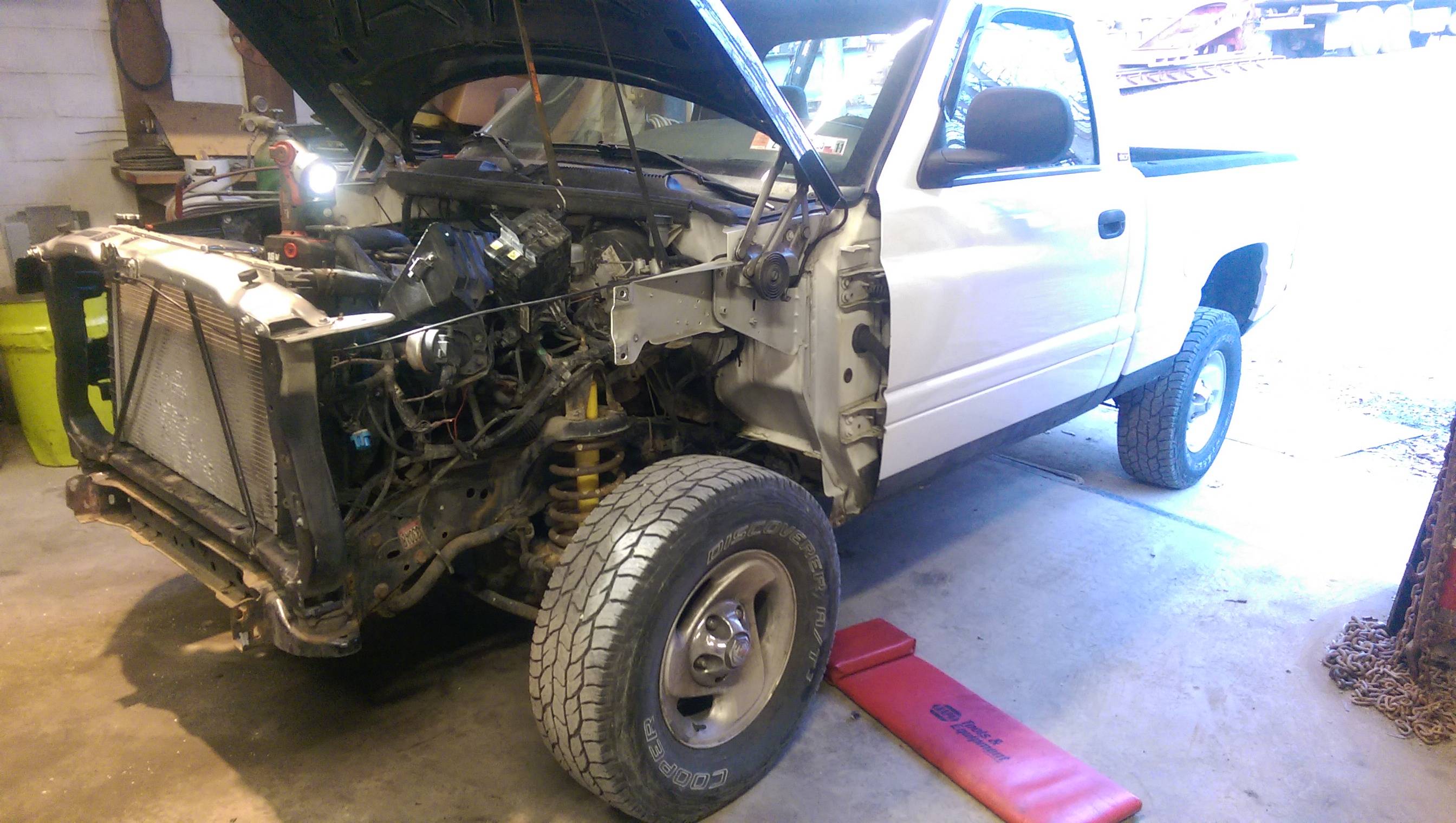

I was able to get my truck to a body shop yesterday where we chained her down and started pulling the frame back where it belongs. It took two good pulls to get it pretty close to where its supposed to be. The hood now latches and is lining up with the fenders nicely. I drove it back to the shop, about a half hour away, with no headlights or bumper. Didn't run into any cops luckily

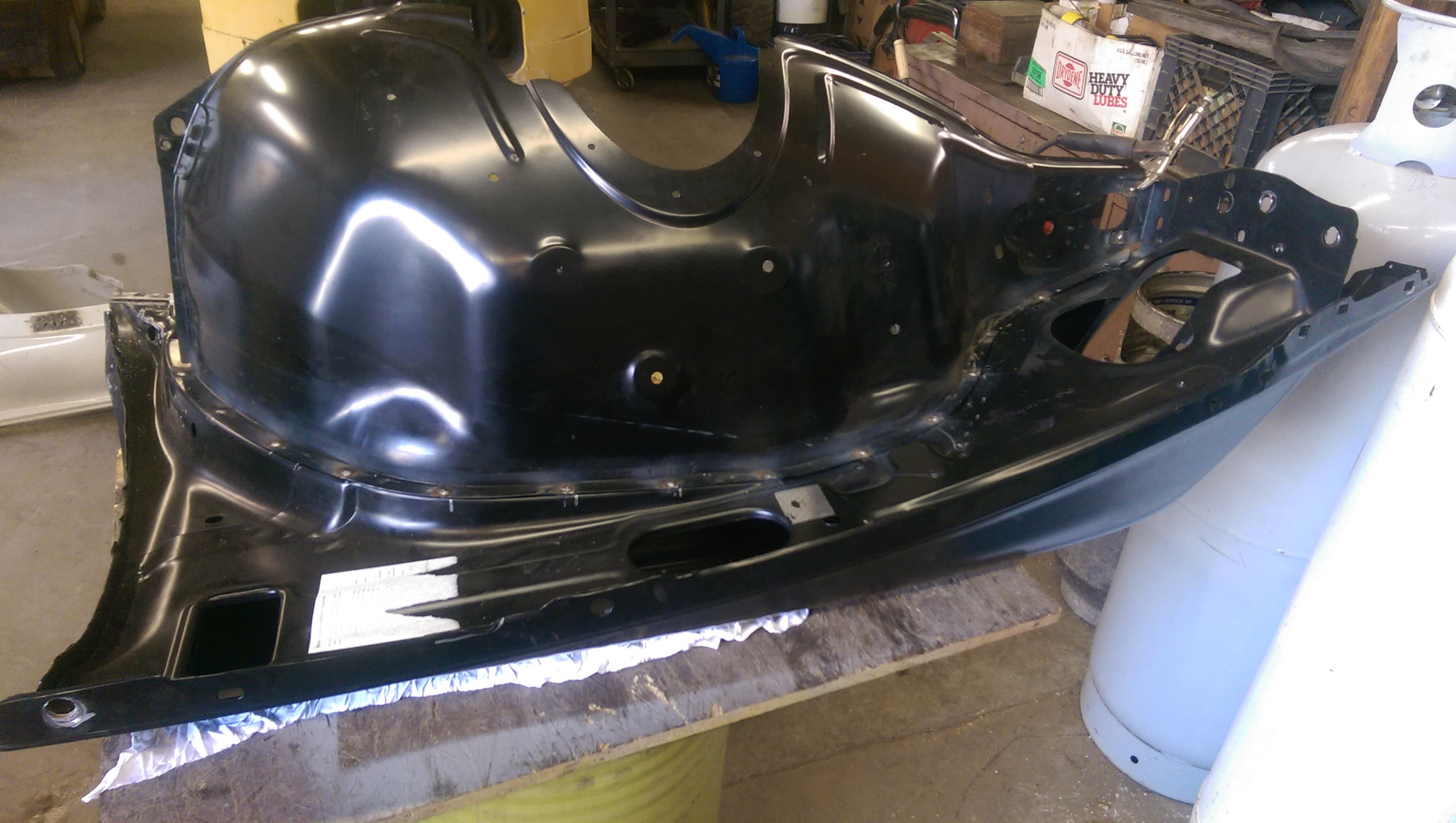

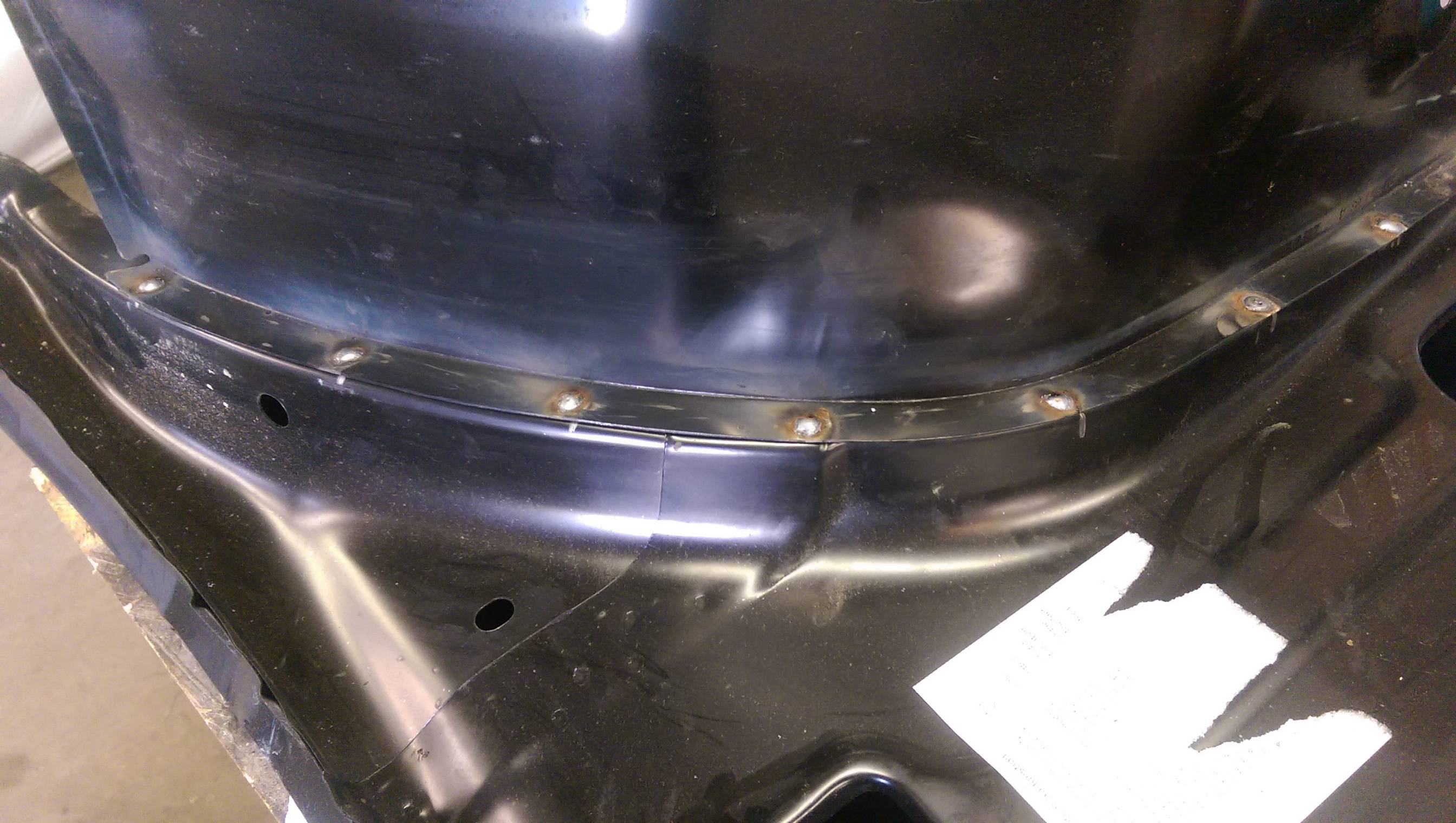

Since I got the frame straightened i've been working my rear off trying to get my baby back on the road. Sunday I got the new (junkyard new) frame bracket that the radiator support attaches too fit, lined up and welded on nicely. Then it was time to weld the inner and outer fenders together. I don't have a spot welder so I drilled 1/4" holes 4" apart from each other on the inner fender, cleaned up the metal, fit them on the truck, then filled in the holes with mig. Repeated same process for the drivers side the next day after work.
There are too many small details that would take too much time to explain. I'm really simplifying this whole thing. If anyone thinks this is as simple as it sound. Its not.
