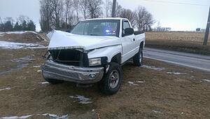

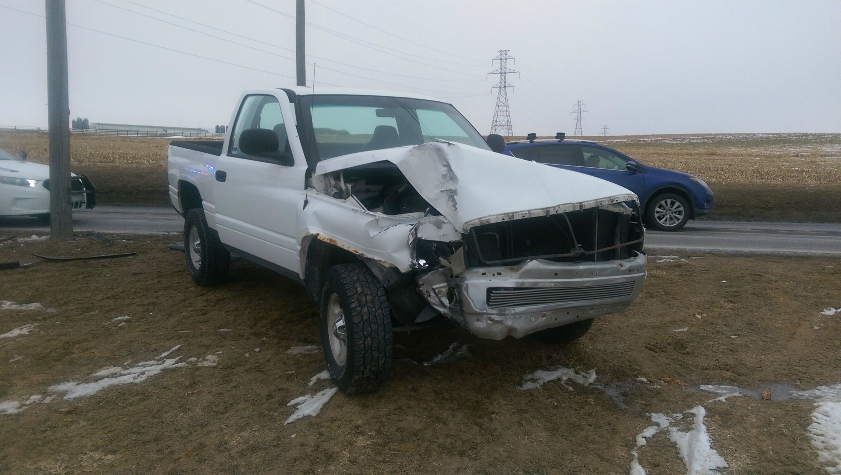

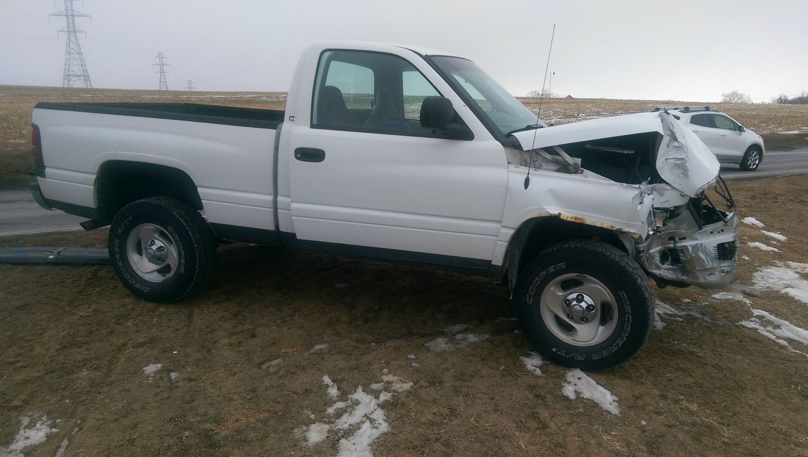

I'm new to forums and this is my first thread so here it goes. It was a very cold winter morning. I was on my way to work when I came to a black ice covered corner. My tail end decided to loose traction and across the lane I went, into a pole. Thankfully there wasn't any oncoming traffic. The damage looked pretty bad but I decided to fix it. I figured i'd share my progress so far.

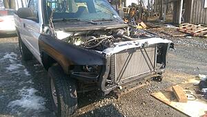

Tear down day one went well. Steering and suspension were untouched.

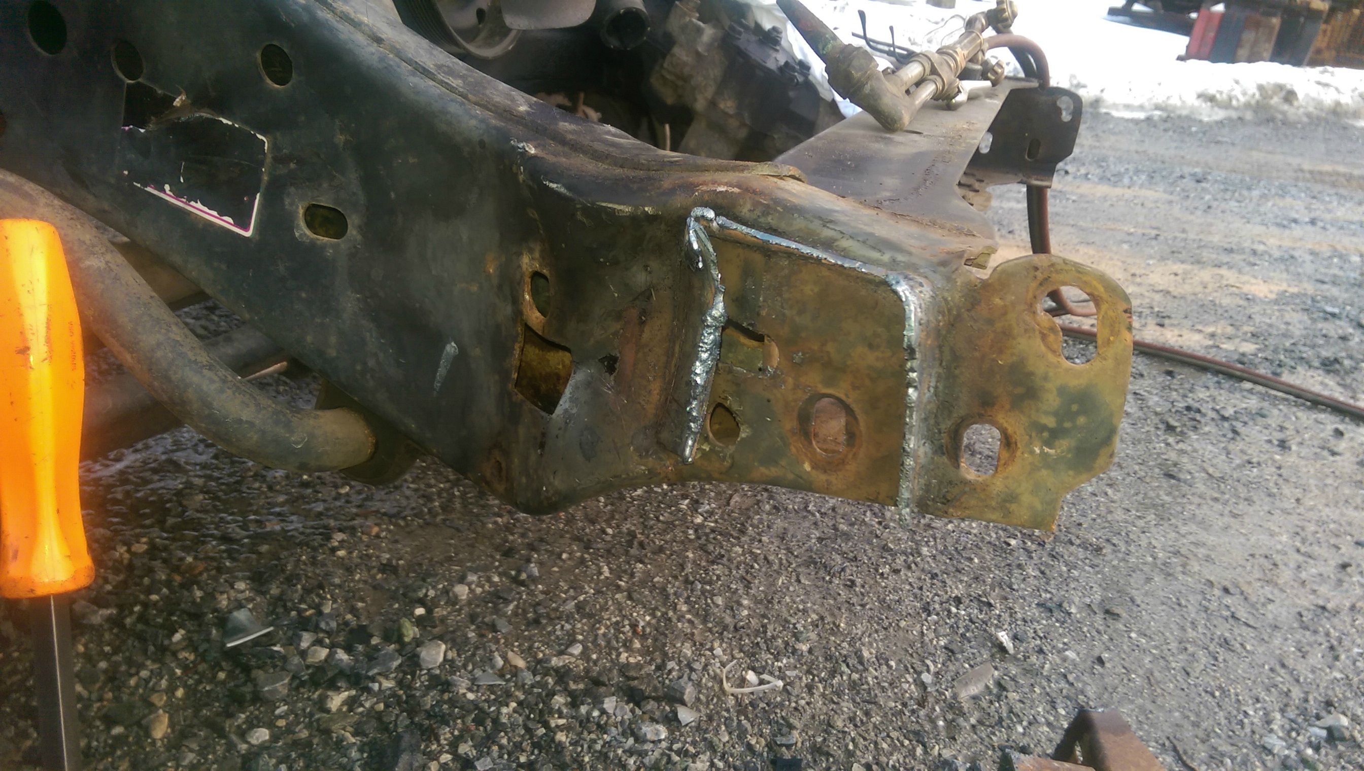

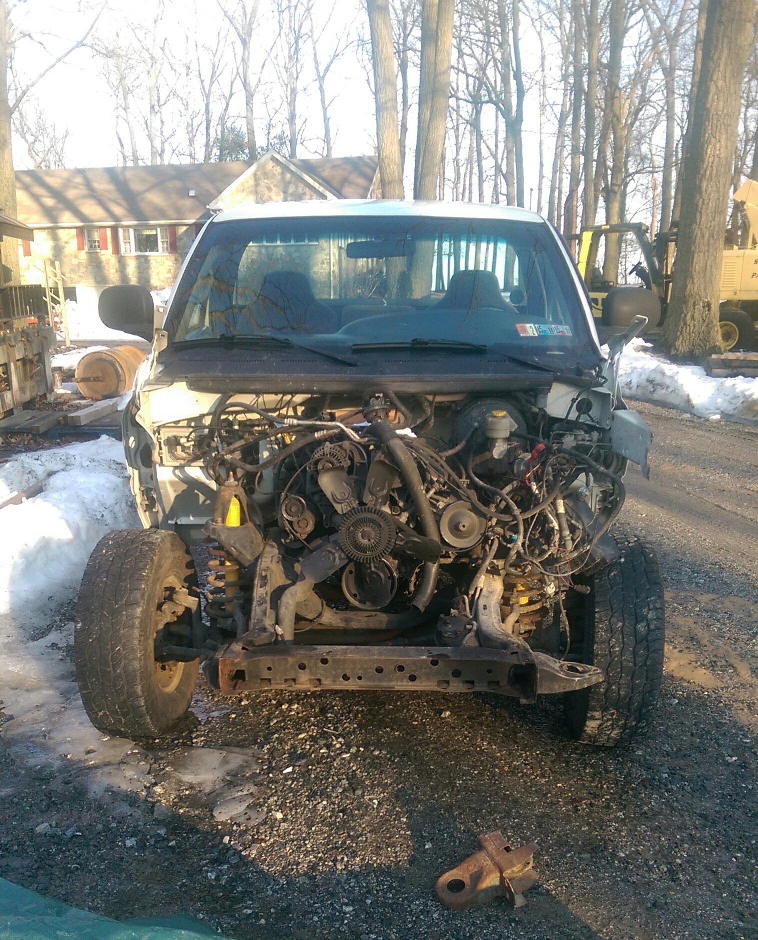

The pole hit right on the passenger side body mount and bent it to hell so it had to be chopped off. (new one at bottom of picture) Once I got all the destroyed parts off and made a list of everything I needed, I went off to a U Pull It junk yard and got all I could find. I was able to find everything I needed except for fenders, a grille, bumper trim and headlights. The rest of the parts I was able to get new aftermarket.

Originally Posted by Ham Bone
Frame bent?
I looked all over for signs of a bent frame. Broken welds, cracked paint on the frame, doors not closing right, etc. Everything looked pretty good until I put the hood on. The radiator support and fenders are shifted to the right enough for it to be a bit of a problem. Got under there with a tap measure and cross measured. From the axle back its good. From the axle forward its off about a half inch.
