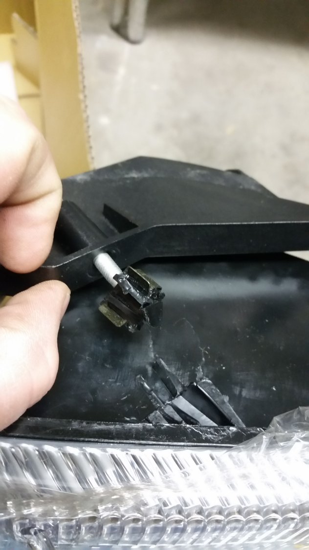

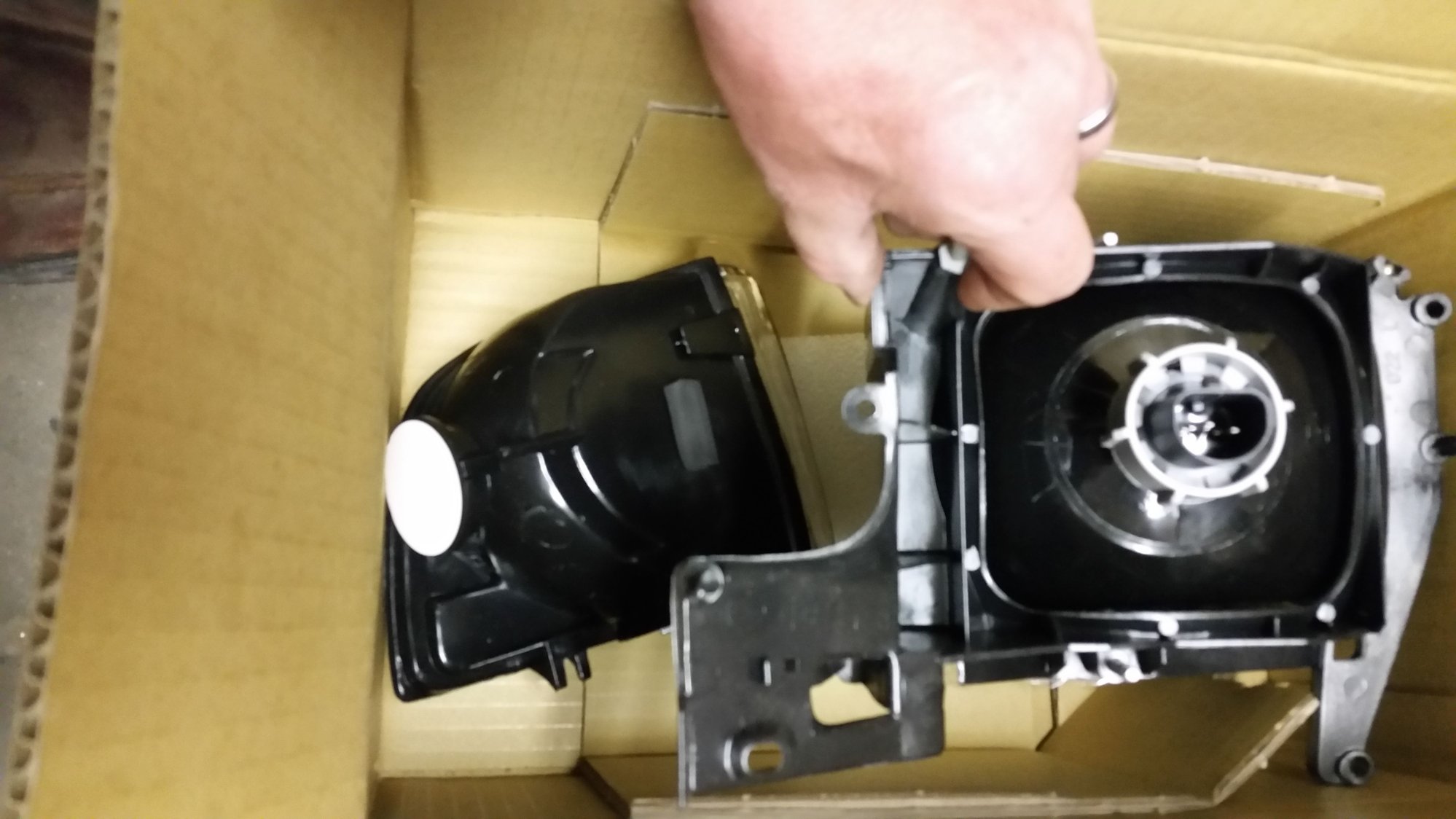

I also had ordered some new stock replacement head lights from AM auto parts. They were delivered today, but the drivers side headlight was busted. One of the adjusters was broken
, and it wasn't packaged right
. The passenger side was fine, and looks good.
These are the lights I ordered. Now we'll see how good their customer service is.
Adjuster busted off the housing.
Poor Packing job.

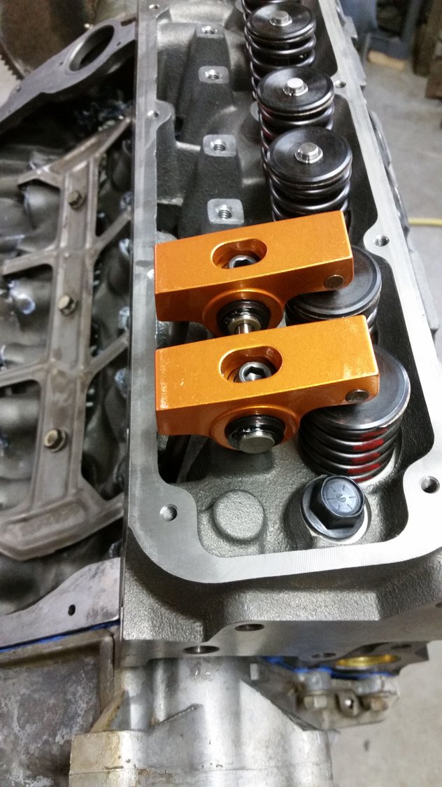

Stock replacement Harland Sharp roller rockers.<br/>5/16 pedestal mount 1.6:1 ratio
Bling out of the wrapper.
Harlands on the head.
Looking down the exhaust runner.
Looking down the intake runner.

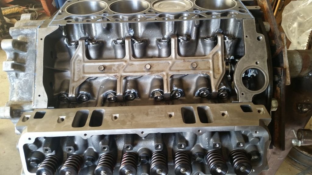

Well, I managed to get most of the big stuff bolted on this weekend. It's starting to look like an engine again.
Front View.
New damper with mark at 0. Timing mark run from 0* to 60*, and there are marks every 90* from 0.
Looking at the valley. One head is bolted down.
Fel-pro head gasket. Looks pretty.
I was hoping to reuse my stock pushrods, but of course they're too long. I ordered a length checker from summit. It should hopefully be here this week, since it doesn't have to travel too far.
