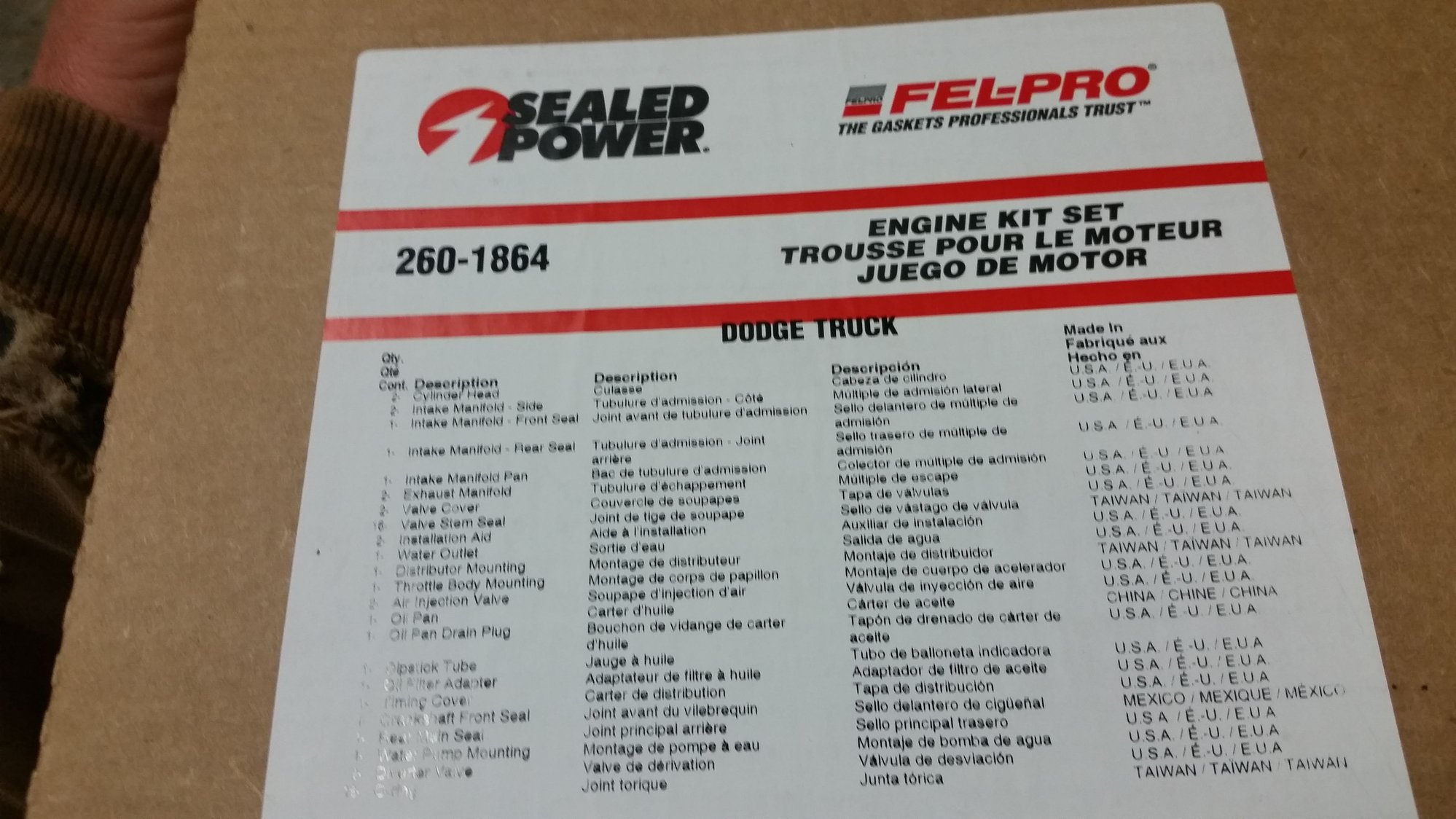

Now, I'm just ordering parts for it. I'll post pics as I can, and as I think about it. Since the block is currently covered up, and the bottom end stuff is buried under cleaned top end parts, I'll start with a picture of the gasket set I got today.
Full gasket set
Sealed power = Fel-pro?

Can you post the link to the kit? #128552 doesn't come up on Hughes engines.
Yes, Owned by Federal-Mogul.

If you mean the gasket kit, the number on the box should come up in searches (260-1864). I got that from my local napa store. It was a special order, and took about 4 business days to show up.
