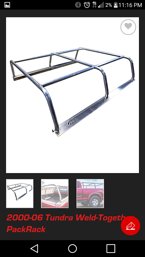

Update 2) Bed rack. I've decided I'm going to go through with ordering an All Pro Off Road Pack Rack for the 00-06 Tundra non welded. I'll probably hold off on doing the Gear Rack and Accessory Bars for now, as I can always add them later on. There's a ton of other stuff I want to do to the Pack Rack down the road, so I'm thinking temporarily I want to get it assembled, then I'll probably just rattle can it black for a while until I can safely call it "done" and then send it off to powder coat. But playing around last night gave me some idea's which I'll give some ideas with.
This is the rack itself, following pictures show the gear rack, and the first picture there you can see a part of the accessory bars. When I do finally get the gear rack, I'm going to relocate my hi-lift to the location shown to get it off the back of my TireGate.

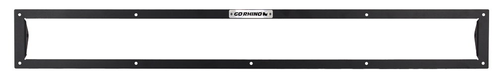

This image is just to show how I think I'm going to mount that Go Rhino SRM rack I have on the camper shell right now. Build off the Pack Rack to make the SRM extend over the cab of the truck. With the Go Rhino finally over the cab, I can swap the panels out to add some more lighting. I know I want to do the Rigid Adapt 50" across the windshield (yeah, mall crawler) but I'm thinking I'll probably throw a Rough Country 40" black series in the front of the rack, then do some Rough Country black pods in the sides.

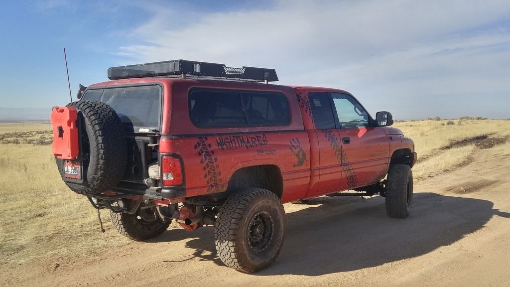

And just for clarity, this is my roof rack I have on the shell.

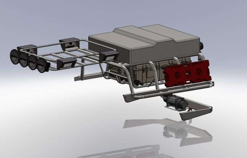

Last update I have here is related to the bumper as well. When I build my rear bumper, I want to add some tail light guards that tie back into the TireGate so it flows a little better than it does now. When I build the bumper, I also want to weld some tabs to the top of the tube and build a ladder to the top of the Pack Rack. Then I'll weld some tabs onto the side of the Pack Rack, making it so the ladder bolts to both the rack and the bumper, making it easily removable. The picture of the Toyota also shows the awning mounted on it, I want the ladder bolted to the driver side of the truck, so I'll swap the awning to the passenger side, then make it so the Smittybilt tent flips off the drivers side. The toyota also shows the RotoPax mounted on the accessory bar, which is where I'll relocate my 4 gallons as well.
And that's kinda the idea. As I said, for now I'm going to start with just getting the rack, and hopefully by All 4 Fun I'll have the roof top tent. I might order some DOM while I build the rack and make my own accessory bars and gear rack with my own designs, we will see.

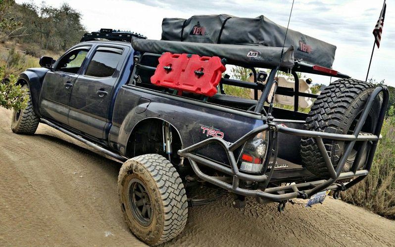

But here's some photo's that represent kind of the look I'm after with this project.
***EDIT: Forgot to add a Lexus LX450 would work just as well, as it's the identical rig***
