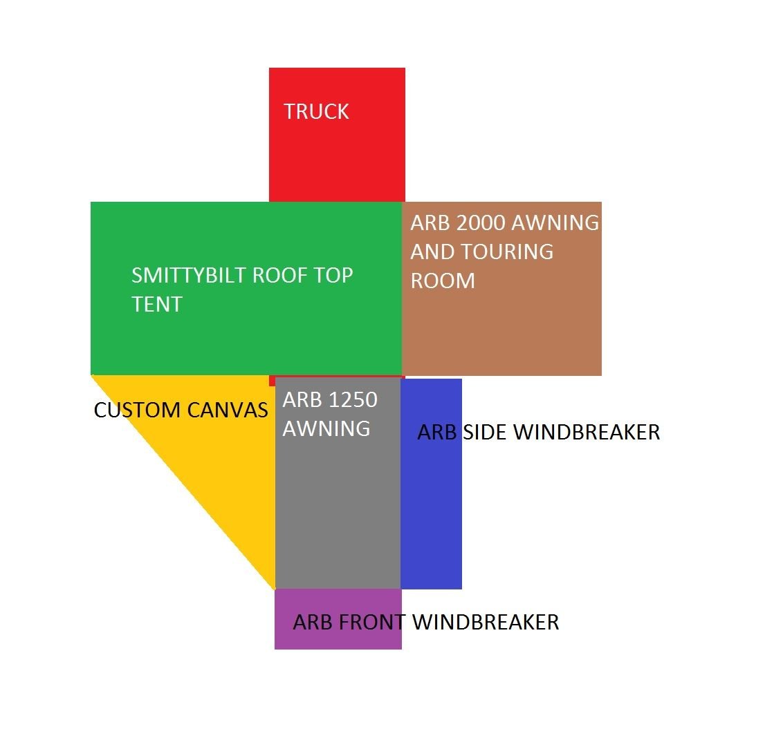

I made a quick paint sketch down below that shows the layout and what I'm talking about.

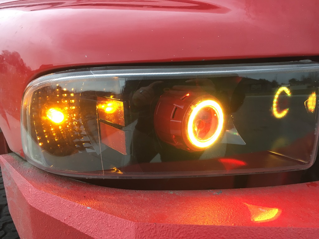

So, couple updates.

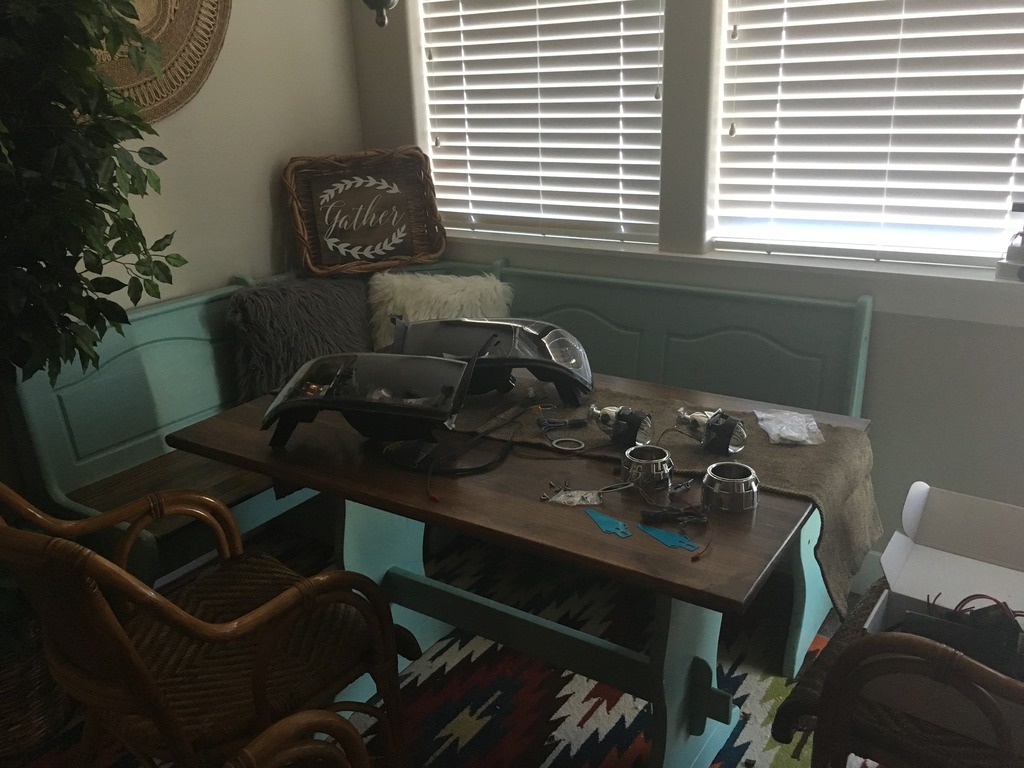

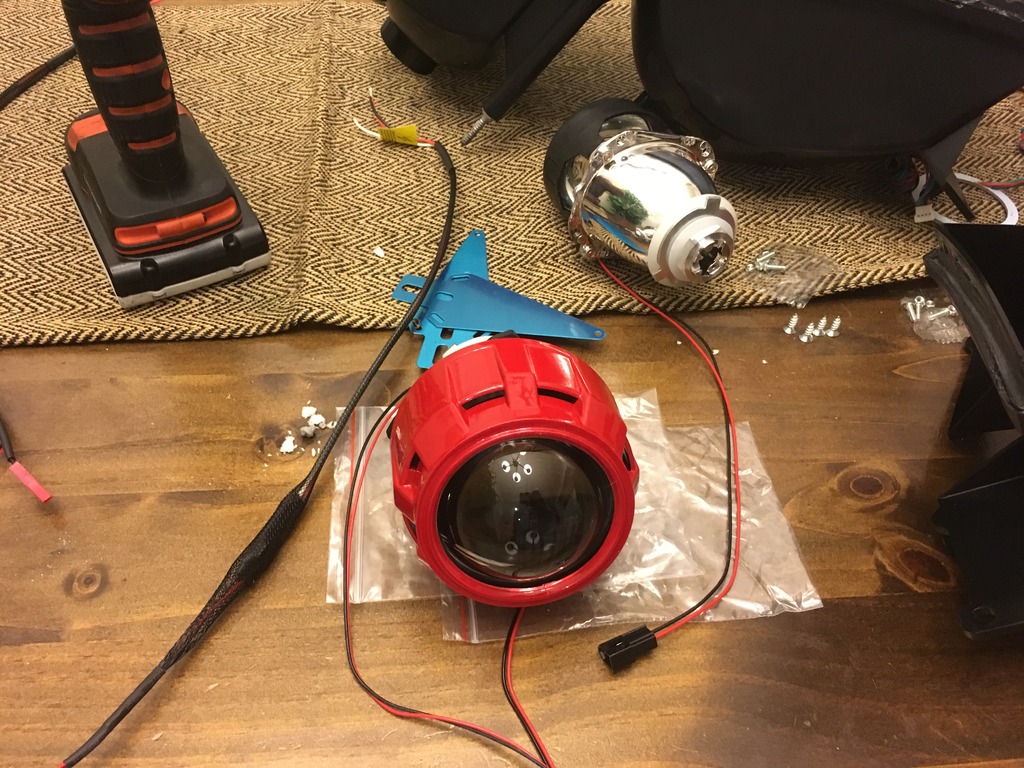

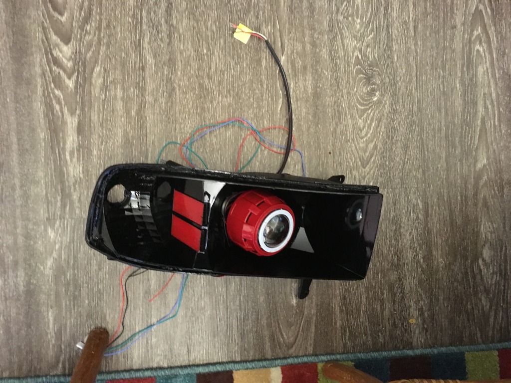

1st, finally got my headlight retrofit "done" last weekend. Down the road I'm gonna pull them again and add a little more, but they turned out pretty sweet!
The halo's, HID's, demon eye's and projectors are from Morimoto. The housings are some cheap eBay housings I picked up.

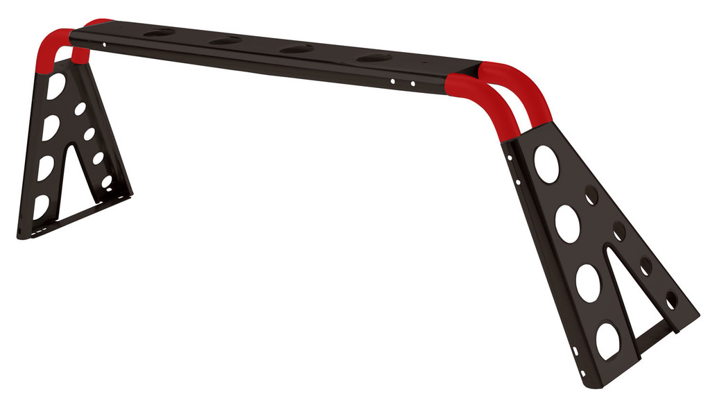

What clicked in my head next was the fact that it's the same style as Go Rhino's Lightning Rack, which is the same roll bar/light mount I was considering a while back.
Gears started turning, and I decided to do a photoshop of it. Photoshop looks like **** thanks to angles, but you get the idea.
After spending more and more time looking for a rack, I decided to pull the trigger on the Lightning Bar's instead. My issue was the fact that they don't make them for a 2nd gen, only 3rd gen and up. I found pictures of a 2nd gen with one, more research resulted they used the 3rd gen setup and I hated the fact that it stuck up over the cab.
So I measured a 3rd gen from a neighbor in our complex, and discovered the cab height from the top of the bed is 23" high. My 2nd gen is 21" high. So, I started browsing more and more and found they make it for the 99-06 GM truck's, which one of my employee's owns. So we measured his, 21" high. I got the bed dimensions for camper shells off google, found out it's identical in width and length. Looked up the part numbers on a distributor's website, even more luck. 2 in stock in my local Portland warehouse.
So, I ordered them yesterday. Delivery will take place tomorrow.
Then, I started looking at it closer, getting all excited. And found for some reason the tubes are a different shade than the uprights and crossbar.
So, again, a little photochopping, and here's the final outcome.
I'm starting off with just getting the rack mounted across the top, completing the "rack" sort of say. For that, I'll either take some flat stock or some 3/16 2" wide strips, run them length wise using the holes in the Lightning bars where lights are supposed to mount, then drill several holes through the strips to bolt the basket down. That's my weekend project for right now.
The Lightning bars aren't designed to hold any weight, so I'll have to keep what I load in the basket to a minimum for right now. I'm gonna get some brackets from Home Depot to be able to mount my ARB Awning to the passenger side, and I know I want to eliminate the trail rack off my TireGate, or at the very least lighten it up as much as possible. So the two 4 gallon Rotopax I have right now I'm thinking I'm gonna mount on the underside of the basket, stacked together on either passenger or driver side. On the other side, I'm gonna stack some red Tred Pro 800 recovery ramps.
From there, I wanna start fabricating everything for all my remaining gear. Land anchor, Hi Lift jack, axe, shovel, etc.
Updated photo's to come probably Monday.
