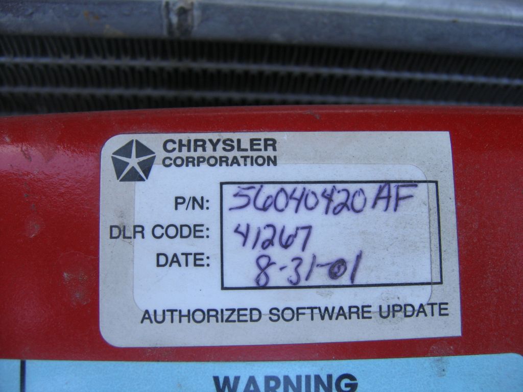

As for the 'death flash' I checked on the PCM - no sticker. Radiator support location: I can't see any labels, but it was still dark out and I was looking with a flashlight...PCM is easy to see...I could have missed a small label on the radiator support in the dark. I'll go look again during lunch.

I did them both around the same time. I scored a set of 4.10's on ebay for $150, (remember you have a dana 60 front axle and dana 70 rear on the V10/Cummins 2500s), and had a local shop do the install. It was $1200, but that included doing both ball joints on the passenger side. Here's a pic of the decal on my radiator support. I think there is a more factory looking decal with that part number overlayed on the pcm/ecm on the firewall.
