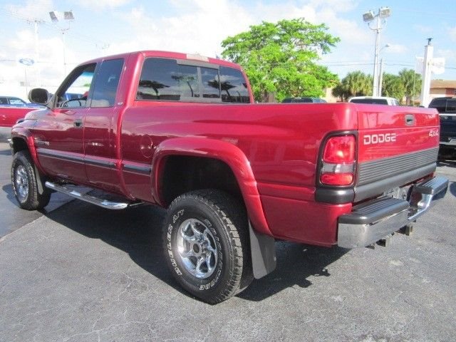

Have a question,
Did dodge put on oem or factory fender flares on 2nd gen rams?
I have a recently bought, 1999 dodge ram 2500 4x4 V10 (pic attached) that has after market wheels with 285/75/16, and fender flares. The flares look like they could be OEM, but I don't remember any of these trucks having them in the late 90s. I'm thinking of painting the truck (the pic doesn't show it but there's about 2000 spots of touchup, ...someone took the time to make sure touch up when on every deep scratch, which is great...but they put a lot of scratches in it.) If I paint it I can't figure out if I want to pull them off, leave them off...pull them off put them back on. Either way they are coming off. At some point in the truck's life it had paint on the drivers side. They didn't remove the flare and the 'gap' between the flare and body is 'sealed' with thick bead of paint. The other 3 have a 'gap' which is not painted 'shut'. I can even gently pull on the 'lip' of the flare about a pinky width and see whats going on in there (don't see rust, see what looks like very old adhesive breaking down and oxidizing). I'm not sure if they will survive being taken off anyway, if they don't and I want to put them back on I'm just curious if these look like they were dodge/mopar made or just aftermarkets...they certainly have a nice level of detail for after market parts.

I'm inclined to believe
1) it's aftermarket
2) it won't survive removal and instillation. Particularly the one that is painted to the body.
It is worth mentioning I won't be painting it myself, it'll come down to primer, and get the same color (PRC/Pearl Metallic red)

I don't think dodge ever did factory flares. When the trucks were still in production, there were a fair few companies that made them though..... Might be able to get them to break loose from the body with a razor blade......

Man, that thing is gorgeous! Still the best looking truck on the road!
Those are aftermarket paint-matched so the PO spent some dough on it. Too bad you're removing them and the wheel/tires. Looks amazing.

Thanks - I kind of figured these had to be aftermarket.

I had those same flares on my last truck, body color and all. I had to re-tape them and what did I find, mopar part numbers on the inside. Then I looked at the window sticker and it had some appearance package. I don't know if the flares were part of it but mopar did make flares. I want to say they were on there from new just by how bad the paint was baked on them.
