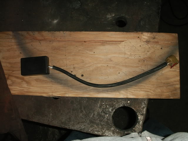

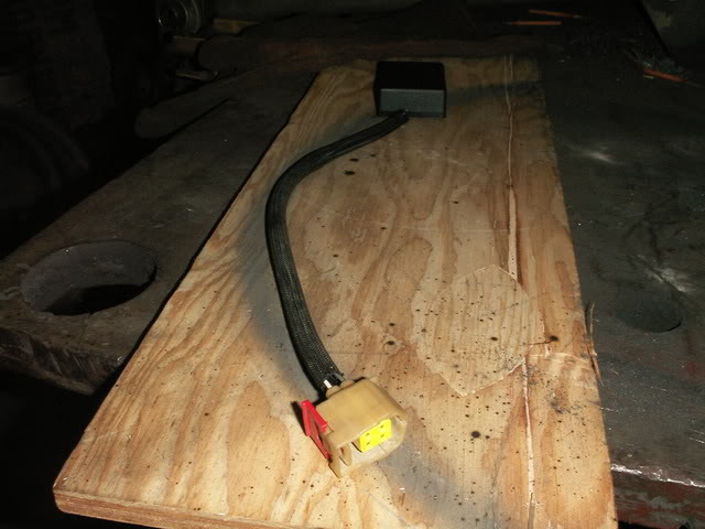

ORIGINAL: Silver_Dodge
How did the mechanic make the 02 splice? Did he cut the original wire, or piggy back splice on to it (the latter would have been better)? Did he use wire nuts or something instead of solder? Also, how did xskyline do his?
Got my O2 sim in today. Couldn't freakn' believe the instructions tell you to cut the plug off the truck and splice the unit it. Not this guy, ain't gonna happen that way. So I went ahead and took my old rear sensor wiring plug apart. Then I installed it onto the bare wires from the O2 sim box. Now if I ever change my set up I just unplug it like it was a stock unit, so far it seems to work great.AND NO SPLICING

Sounds sweet man. Skyline, how did your truck run prior to the rear sim, in other words, did you ever experience your truck going through the bullcrap it did? Did you ever splice your wires, or did you just never plug your rear o2 in? Or did you have it plugged in still?
***Also, I think some people are getting confused here (probably my fault). The truck started acting up the first time I got it back even before he spliced the wires. So I don't know if he did any splicing the first time or not when he originally had it butted up against the passenger header collector. The 2nd day of the headers, that's when the truck began randomly shutting down on me in the middle of the roads. And then slowly over time, the poor ideling, and random shutting off became worse and worse..
