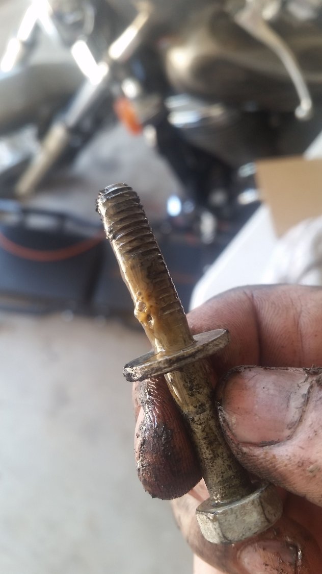

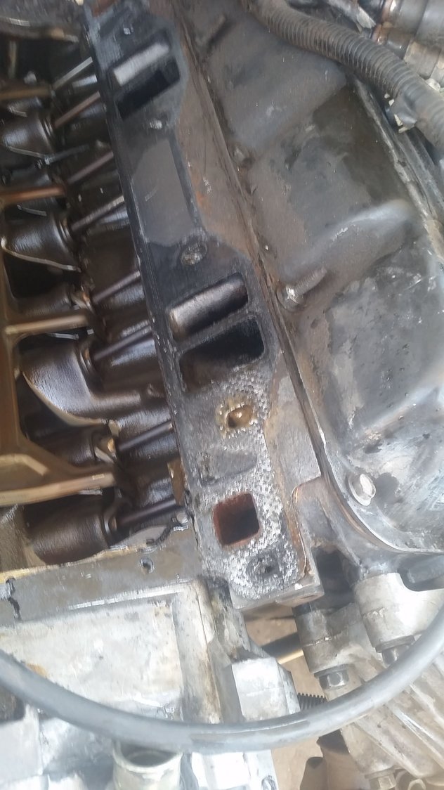

Okay gents,
It seems like I keep running into new things. I have my truck apart and am curently working on the intake and cleaning the trottle body. Oh boy, what a mess.
Any how, When I pulled my intake off I noticed a greenish sludge filling my injector port (cylinder #1) and as I inspected the bolts, it was also covered in said sludge. It was also present on the intake. (See pictures)
Now, is this a result of the coolant not being drained all the way before ai temoved the intake or is it infact what I fear?....a blown head gasket.
The oil in the lifter valleys wassnt all slimy and greenish, it was dark brown (probiably needs to be changed) and the coolant is a lime green color, no odd colors there.
Intake bolt, coated with mucus colored sludge
Bolt hole on drivers side. Near cylinder 1
Underside of intake manifold, bolt hole #1

Old Aug 9, 2015 | 07:48 PM
  #336
Posts: 87,399
Likes: 4,214
If you look close at the last pic, you can see gouges in the manifold gasket surface, that just about connect the bolt hole, to the coolant passage.
Think I would just make sure I used RTV around the coolant ports, on BOTH sides of the gasket.
Old Aug 10, 2015 | 11:24 AM
  #337
YEMX Ret.'s Avatar
YEMX Ret.
Joined: Nov 2013
Posts: 9
So you dont think its a blown head gasket? Now that you pointed that there are gouges inbetween the bolt hole and the coolant passage, I can see it now. It makes sense that the gunk was olny in that spot and on the bolt. I have new gaskets for everything, so if that really is the issue, then Its going to get fixed during reassembly anyhow.

Old Aug 10, 2015 | 12:12 PM
  #338
Posts: 87,399
Likes: 4,214
Head gasket would put it in the cylinder, or, into the oil pan. Not an intake bolt.
