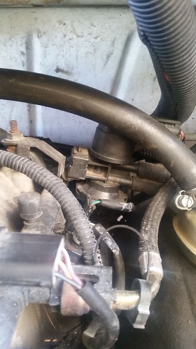

Okay, maybe I am wrong. I just went and took a peek inder the hood again and what I do k ow for sure is back there is the oil pressure sending switch and the distributor....
What is this then? (See picture)
Old Jul 23, 2015 | 03:25 PM
  #327
Posts: 87,399
Likes: 4,214
Nope, that's the cannister purge valve. EGR valve (if you even have one) will be on the intake, behind the keg, passenger side. Metal can with a vacuum line or two going to it.

Verry well, I stand corrected then. Thanks for setting the record straight.
So, I dont have an EGR then.
