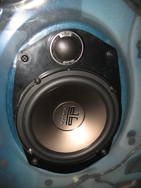

I will show you in a second how I did my components. I mounted the tweeter over the speaker so it's all hidden. They didn't fit in the pillars where the stock one are and I didn't think they would look too good If I customized it to fit.

Here you can see how I mounted the tweeters over the speakers and you can also see the mounting plate that allows you to mount 6.5"s instead of 6x9"s. I just couldn't decide where to put the tweeters and didn't want to chance messing up cutting up the pillar so I finally decided to put them here and they don't sound bad and look totally stock. You can't tell they are there.

The speaker got mounted a little turned on this door as you can see but you can't see the logo anyway with the door panel on. That's how the holes were drilled from before( I think I had them from before) so since I couldn't get it perfectly straight I didn't worry about it.
The other side is pretty much dead center for the logo though.

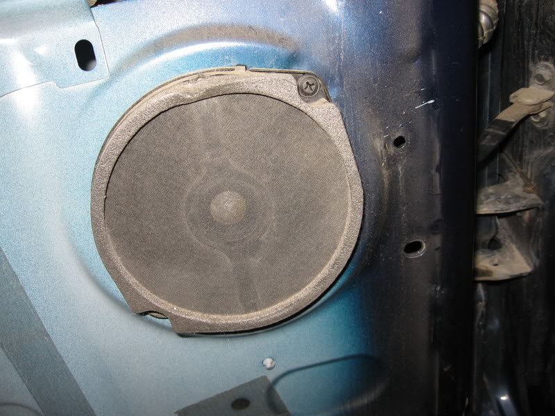

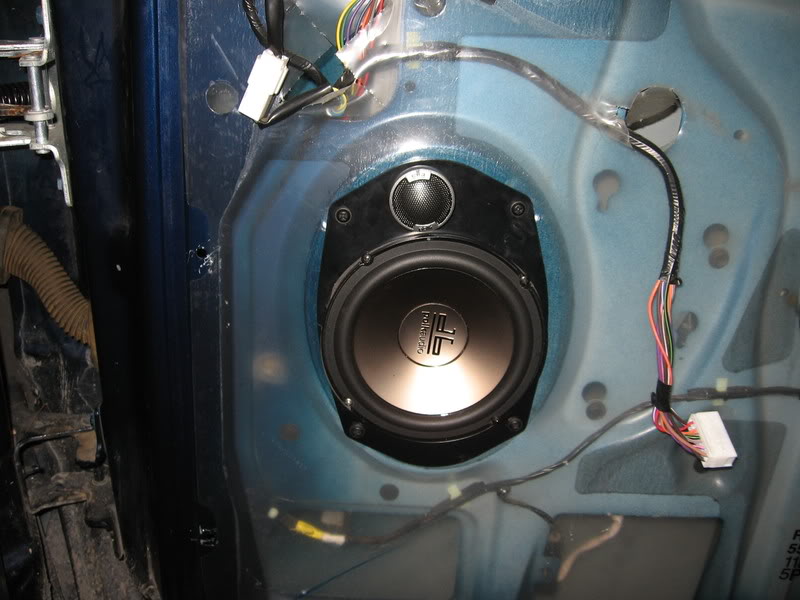

This is what I did on the rear.
Went from this
To this
I had those speakers up front at first but once I got the components I moved them to the rear and that's when I added the amp that powers all for of them.
