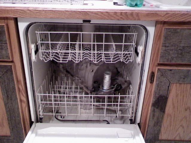

It's all apart now. It took about 2 hours from opening the hood until the manifold was lying on the garage floor. The plenum gasket was TRASHED. I have no idea how it wasn't pinging and how it was using so little oil (about a quart in 1000 miles, or so). I also know that I have a sludge problem; I'll be running some engine flush tomorrow when I do the required oil change.
Getting the gasket material off of the pan from around the bolt holes is turning out to be a b1tch. I have it soaking in parts cleaner (the kind that comes in a paint can) right now. Hopefully it'll be good to go in the morning. Tomorrow is changing the valve cover gaskets and reassembly.
At this point, I have to say that the disassembly was a lot easier than I thought it would be. Everything was more or less accessible and came apart very nicely. Before reassembly I'll need to pick up some heater hose, a chunk of hose for the water pump/manifold connection, fuel injector o-rings, and a new hose to connect the two fuel rails together (didn't have a quick-disconnect tool for the fuel line... long story).
Right now the intake manifold is running through the dishwasher. I tried cleaning it with brake cleaner, scrubbing it in the bathtub with dish soap, a scrub brush, and a bottle brush, and it still wasn't clean enough. Hopefully the dishwasher does the trick.
The intake ports on the heads have a lot of carbon buildup. I'll have to grab some Mopar combustion chamber cleaner next week and run that through. I'm not really sure how to clean out the ports on the heads... if anyone has a suggestion I'm open to it.
Fun times.

Nice work. That dishwasher pic is hilarious. My wife would have killed me.
I used Mopar Combustion Chamber Cleaner to clean out the runners on mine. Just sprayed it in and let it set, then rinsed it out, and it came very clean. I took mine to the car wash and power washed it.
