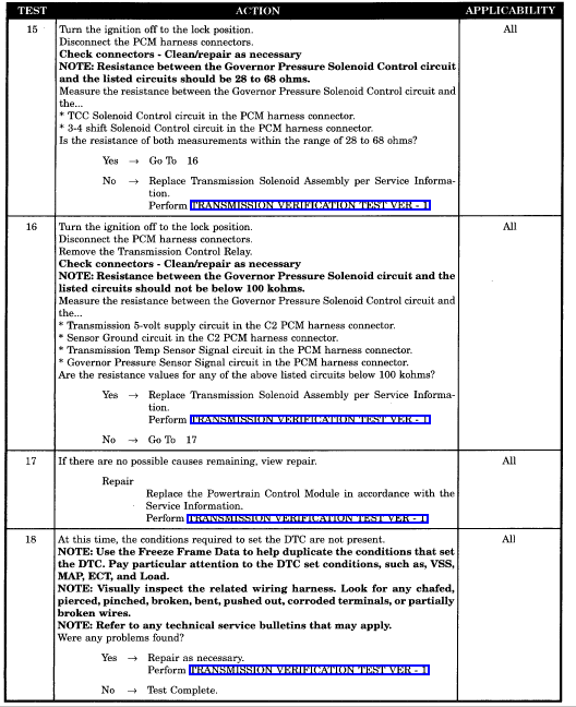

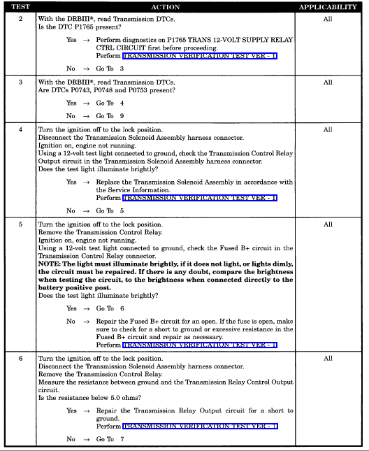

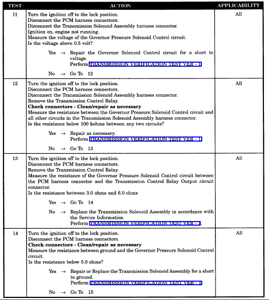

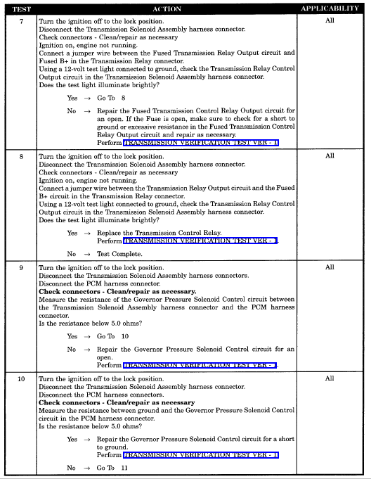

Old Feb 19, 2009 | 07:32 PM
helms's Avatar
helms
Joined: Jun 2007
Posts: 981
From: Langley, BC, Canada
sorry if these are hard to see, hopefully your moniter is big enough, its the best i can do
