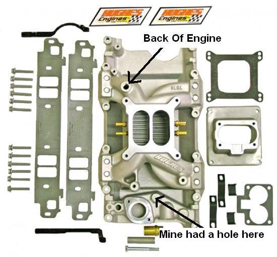

Originally Posted by BlueBeast2
The thing thats gonna **** me off is they have some bracket at the bottom of the page. If I need that thing and its not mentioned I'm gonna be mad
You should have four brackets. You need the to moun the Fuel rail back in place. Two look are U shaped and two are longer and bend to attach. If you do not have them I would call. Also they sent me a rubber gasket for the front and back of the intake and it did not work because the manifold sat to high. So I took them out and used the RTV silicone. I have had no issues with leaking. One more thing, I remembered today(because I found the extra plugs in my center console today). I had to buy two brass plugs to fill two holes on the intake tha I didn't use.(illustrated by the two arrows on the picture)I am not sure if your truck has the extra stuff that mine didn't but you may want to pick a couple of them up prior to starting your project. I added this picture to show you where the holes where and if you have them you can take the intake in and get the plugs prior to install. Other wise you'll have to do what I did and buy everyone that they have and see which one fits.

Oh by the way that is the picture I had when I ordered my intake. No mis-representation there.

no its some throttle bracket jobber for 55 bucks

I'm not sure that it is the bracket that you are talking about,
But let see what others will say.
