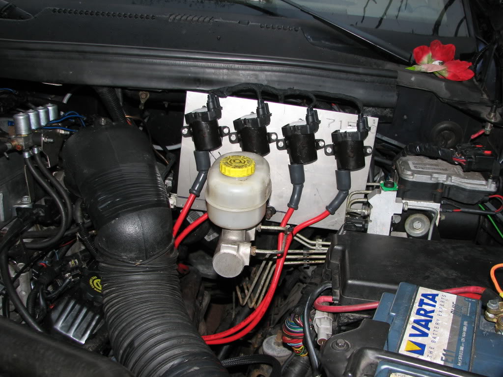

Ls1 coils with the MSD wires behind the mastercylinder

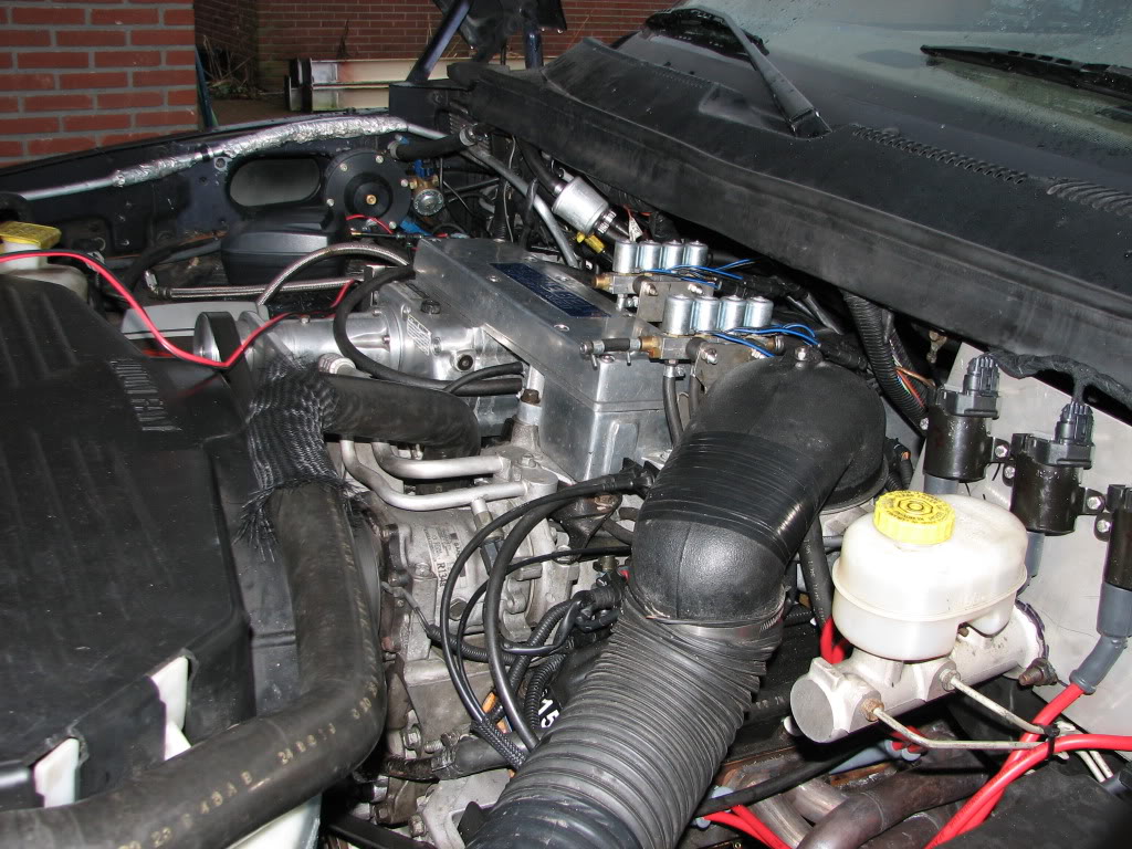

Supercharger with the Propane injectors

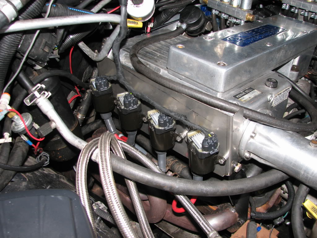

LS1 Coils next to the Supercharger

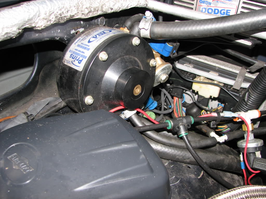

Propane vaporizer

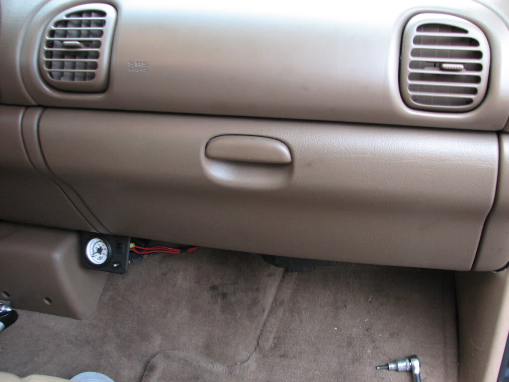

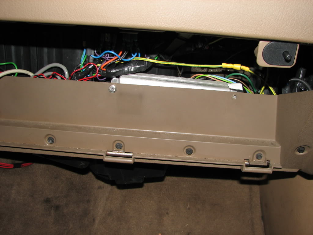

Megasquirt and wiring behind glovebox
With glovebox
