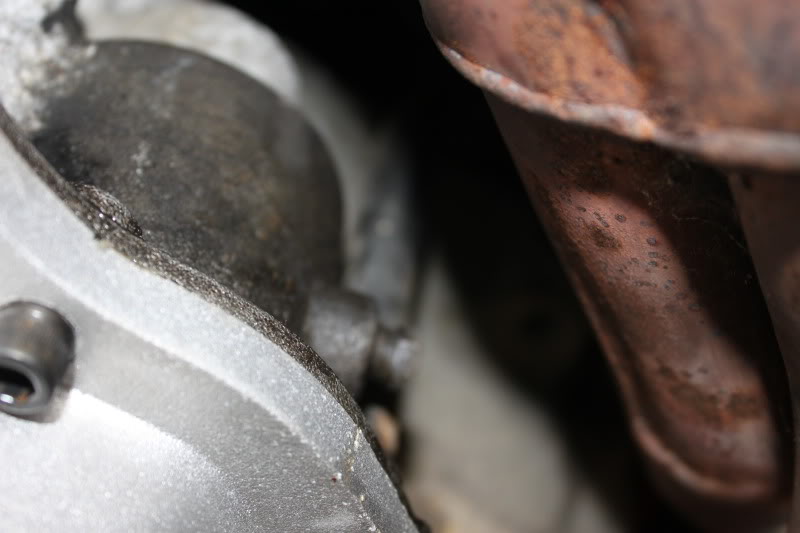

I know theres DIY's and all that for this. However none of the pics work anymore. Is this the test port where your suppose to stick the sensor?

Old Nov 20, 2009 | 02:59 PM
dodgeram07's Avatar
dodgeram07
Joined: Mar 2008
Posts: 3,363
From: ohio
theres sum good info,,,,,front servo port
https://dodgeforum.com/forum/2nd-gen...emp-gauge.html
hope this helps
Old Nov 20, 2009 | 03:33 PM
PurplDodge's Avatar
PurplDodge
Posts: 8,321
Likes: 12
From: Indiana
Yes, that is it.

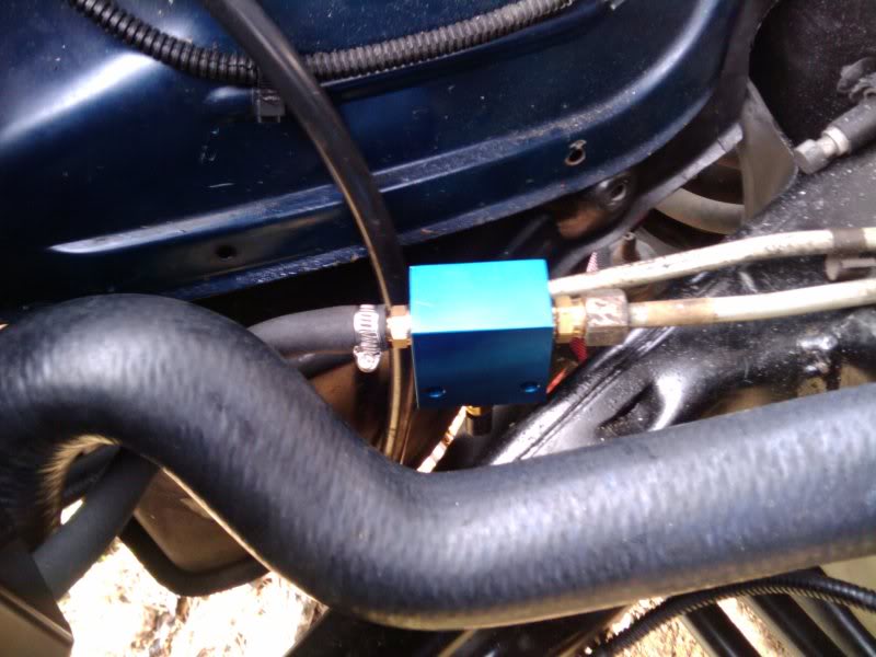

Monte what's shakin'? I ended up with this Name:  2009-12-18120904.jpg
Size:  61.3 KB It's a autometer temp sender manifold. Goes right before the rad cooler.
The other day I was up to 179 I am courious as to what they are after the coolers
Old Apr 11, 2010 | 01:40 PM
contractorben's Avatar
contractorben
Posts: 97
From: Augusta, GA
I have one with manifold right before cooler too. The highest I have seen it was at 210 the other day, but it was hot outside and I was in traffic. I have the isspro EV2 gauge, only had it for about week now though.
Old Apr 11, 2010 | 01:44 PM
BlueBeast2's Avatar
BlueBeast2
Joined: Jul 2005
Posts: 2,966
From: Greeneville, TN
After messing with the ports and all that I honestly think the manifold is the easiest option.
Old Apr 11, 2010 | 01:56 PM
contractorben
Posts: 97
From: Augusta, GA
Well I talked to MonteC about it and he said it would give a better reading. He just rebuild tranny so asked him to put manifold on and I wired the gauge up.
Old Apr 11, 2010 | 03:27 PM
MonteC's Avatar
MonteC
Joined: Nov 2003
Posts: 1,256
From: North Charleston, SC
In the feed line (comes out of the torque converter) your going to see from 180-200ish, upwards of 230 max. If your seeing 230 stop and let it cool down, if it keeps going up to 230 you are working the trans too hard.
On the cold side it will be about 20-40 degrees cooler, depending on how efficient your cooler is.
