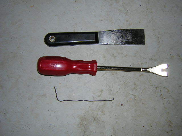

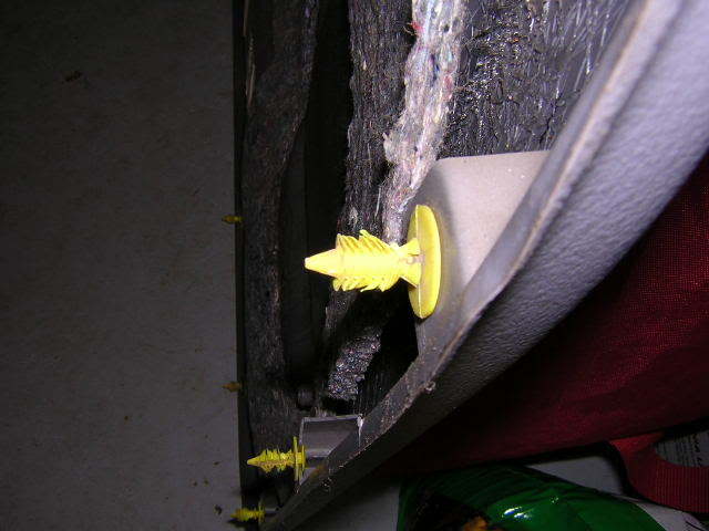

here's some pics of the christmas tree clips.
get the panel tool. its only 10 bucks at autozone and it'll save you from breaking your panel and having to replace the clips.
the clips have a notch in them. the forked tool catches in the notch and pops the clip right out.
use a plastic putty knife or similar tool to slip behind the panel to locate the clips. it won't scratch the paint like a metal tool.
