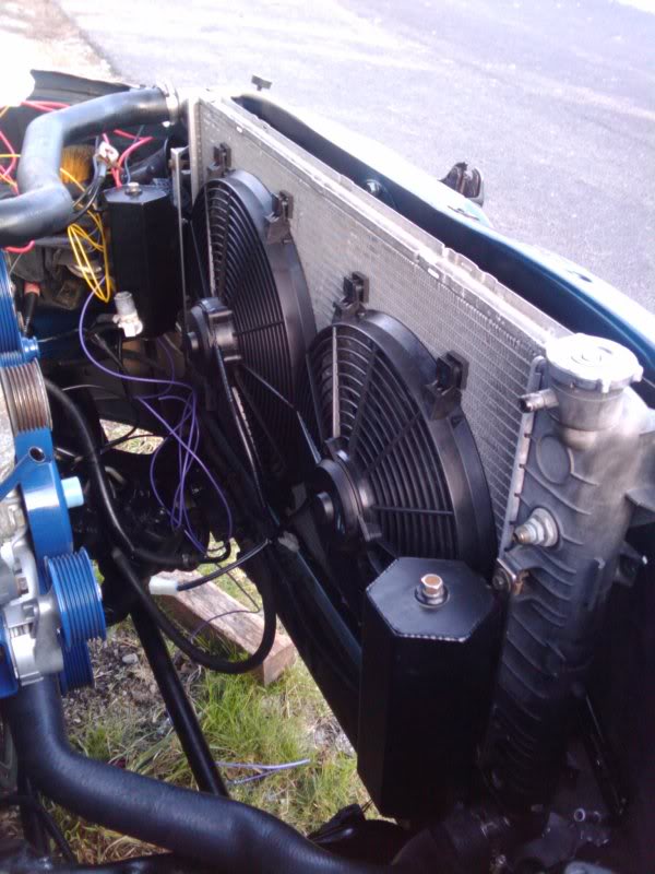

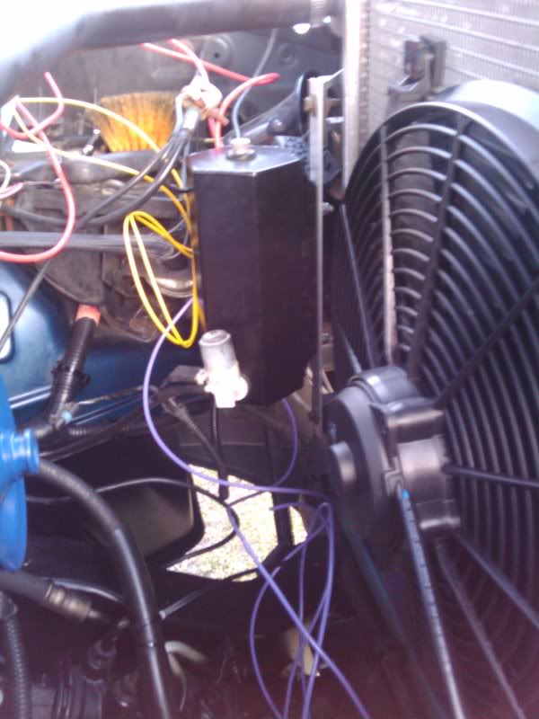

A lot of people ziptie their tanks in place after removing the shroud. Moe's sells a kit with 2 bottles that looks really nice. They are on the expensive side though.
