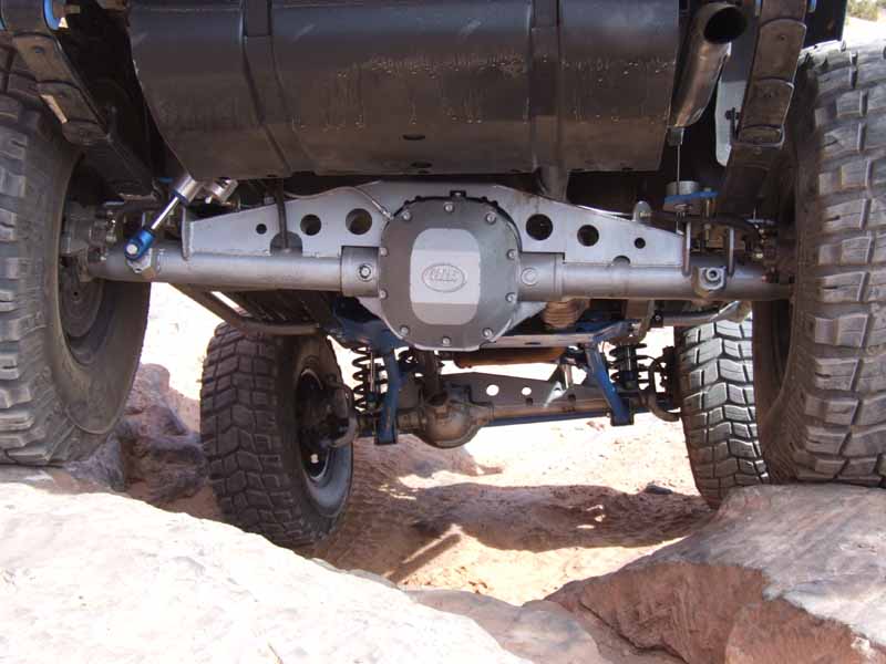

Used to be you could buy a bolt-on axle truss to prevent axle sag or bending. This was basically a rod with a perch that sat under the pumpkin. The ends were threaded and went through a clamp mounted to the knuckles on each side. A big nut would be put on each end and tightened to either straighten the axle (if already bent) or keep tension on it to prevent bending.
Like this one:
http://www.fourwheeler.com/techartic.../photo_03.html
Newer designs are beefier and can be bolted on or welded on. Like this:
