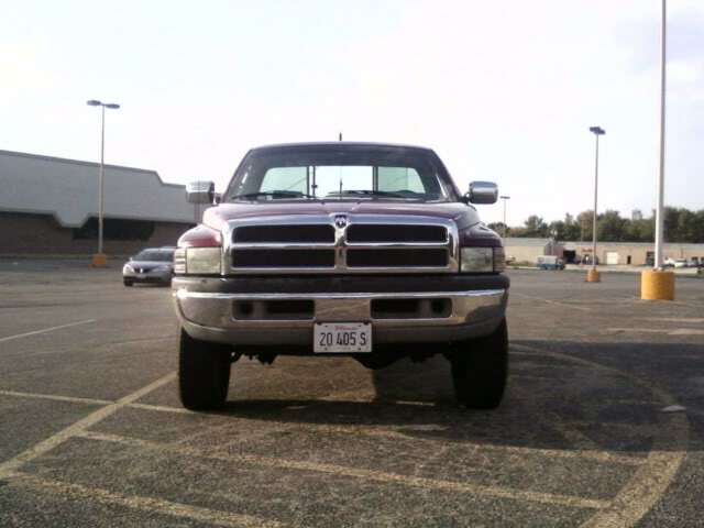

def sounds like ball joints..and trust me i know all about them...my bottom right lower is going out
you can tell it by looking at the pic below
personally i think your rims might be the culprit..depending on if your bjoints are originally or not..
another way to check your balljoints is to put the front end of on JACK STANDS..not a jack..put em high enough that the front tire is off the ground about 3-6 inches..then sit down facing one of the front rims..and pull on the bottom of the tire..(cause with the description you explained and the fact that the bottom ones usually let go more than the top)..anywhoo.pull on the bottom of the tire..dont be afraid to put some muscle into (hence why i said jack stands) it..if you can feel your tire come out towards you at all basically if you can wiggle the bottom of your tire..
its your ball joints..and cause your in the 94-01 class 4x4..those C style front knuckles..if your bottoms are going your going to have to do the top as well cause your gonna stretch it out putting the bottom one on anyway

That is exactly what mine looks like..... sorry i diddnt get any pics of my own but i was kinda busy with the army thing, I just changed my driverside hub about a month ago and 3 of the weeks of the month the truck was in the shop getting regeared. I did jack up the passenger side wheel and did the ball joint test and it move <.25" but that probably is the problem. Thanks for all the help and ill let you know how it works out.

of course thats just my opinion and experience and you can see how bad mine is in the pics above
