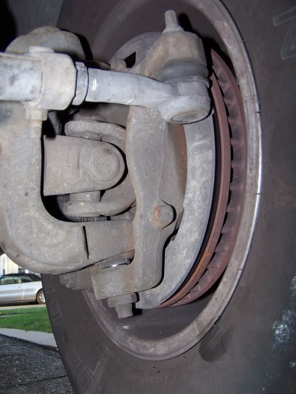

I was under the truck today and I noticed that there are no wheel stops to prevent turning the wheel too far in either direction. What happens is I bootom or top out the steering stabilizer putting tremendous strain on it and then the tie rod arcs. No biggie, as I rarely turn that far, but all my previous trucks has adjustable or welded in bolts to stop you from turning too far. There appears to be a provision for this on the knuckle, but when I tried to put bolts in them they did not line up with the stop on the axle. Anybody got a shot of their wheel stops? Here's my knuckle:

Isn't this the stop?
When I was doing my front end work with the steering link off, the knuckle would stop on this and there is another on the back side of the axle yoke.

see i looked at that too but i think thats only one part of the stop. I thought there was another part that was adjustable?

Mine looks the same as the pic

The knuckle never makes contact with that. That's what I thought a bolt in the hole on the knuckle in front of that stop would contact, but when I put the bolt in they did not line up.

Sorry folks but Ma Mopar did away with the fancy adjustable bolts...I'm thinking the late 80's. They always rusted up and were snapped off anyway. Well, up North anyway.
One guy I know added a bit of weld to the axle side of the stop and pencil ground it to the correct length.
Or you can try drilling and tapping it....

Yeah, I know they were on my previous '70s era Dodges. I thought about doing the weld thing, too. My concern is that off-road I might get into a situation where I turn the wheel too far and I could probably snap the dampener right off or damage it.
