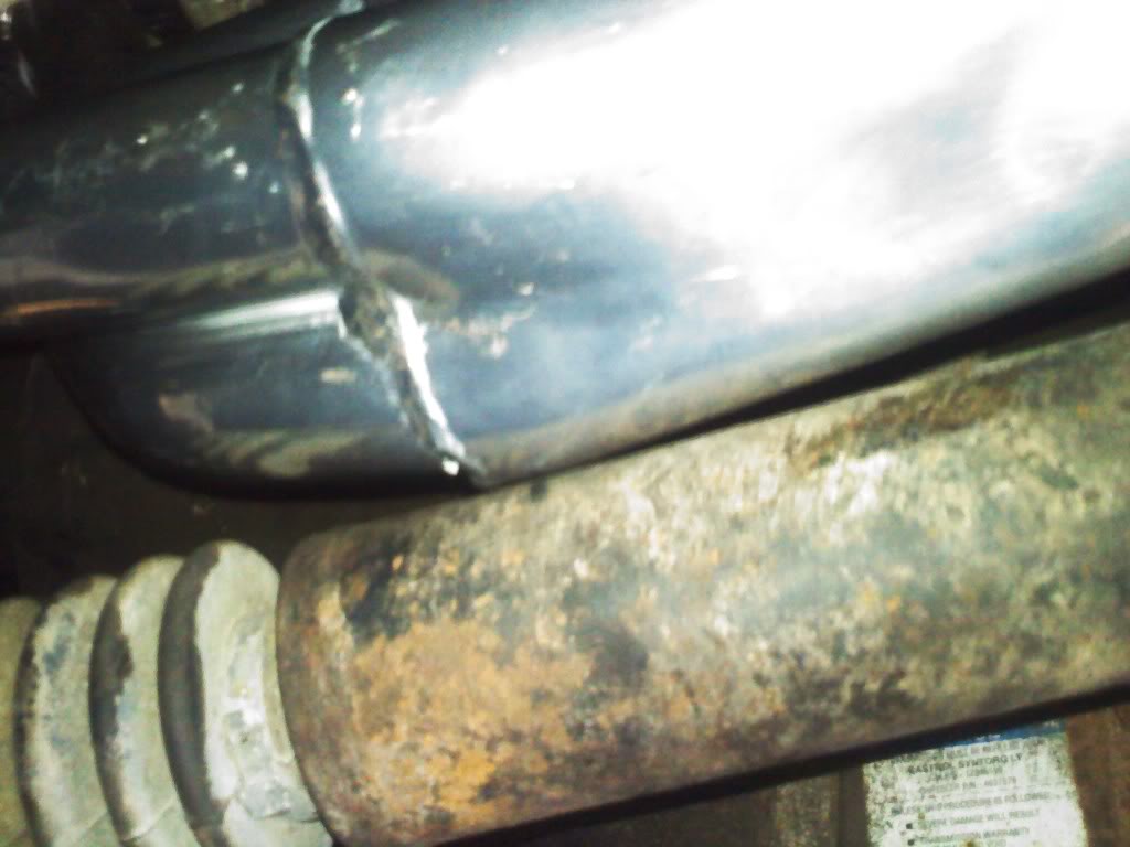

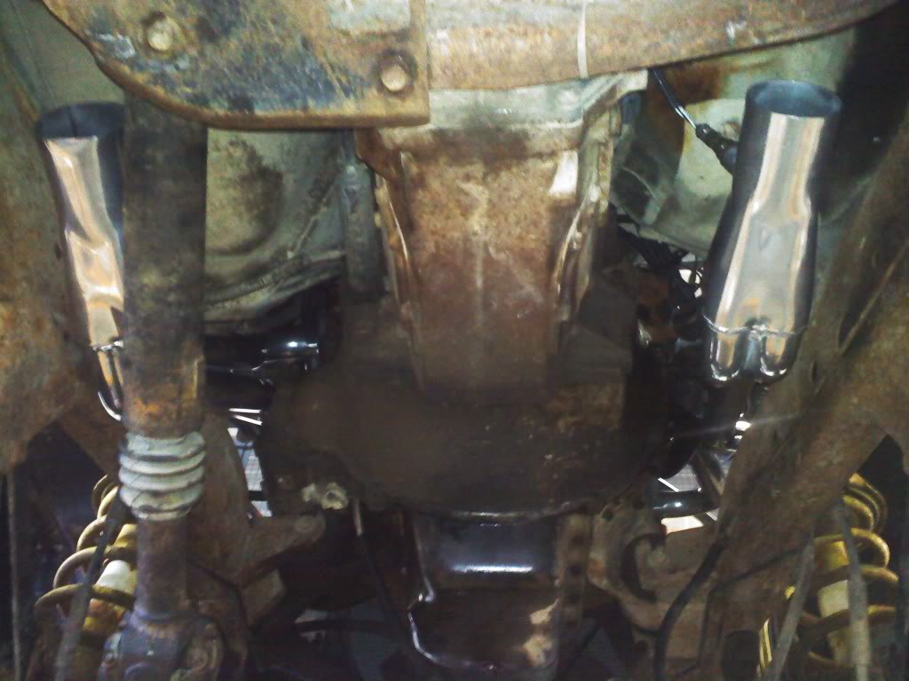

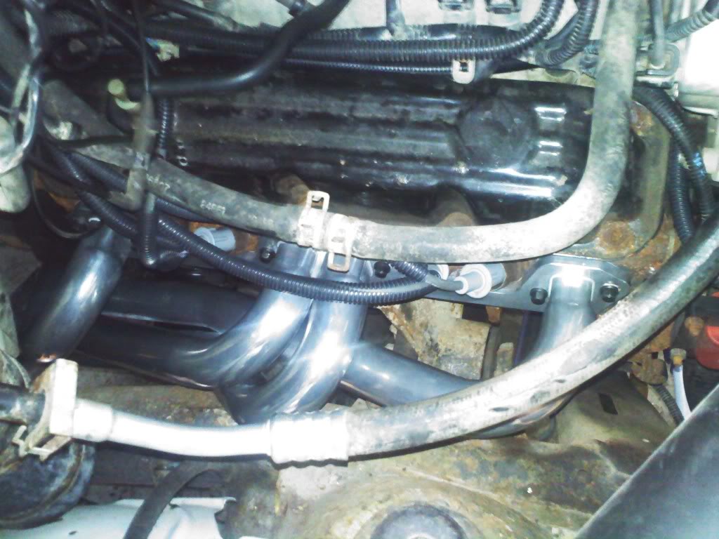

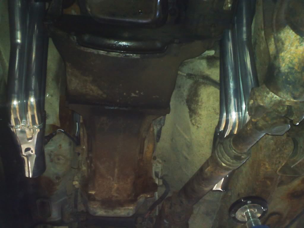

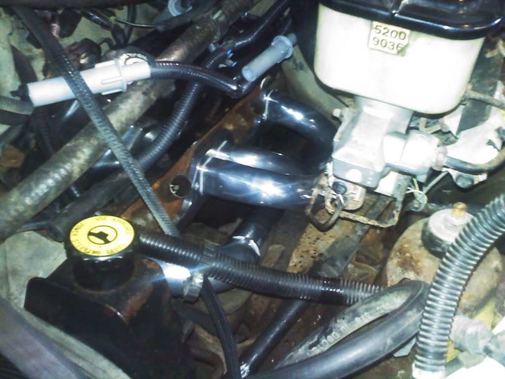

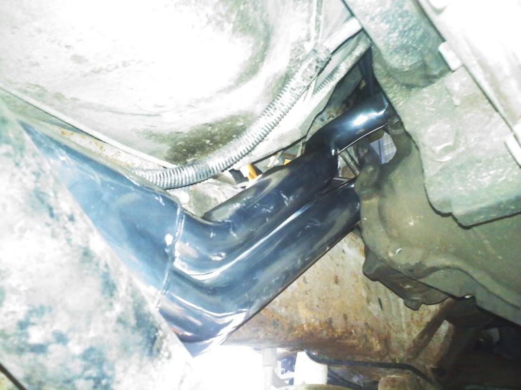

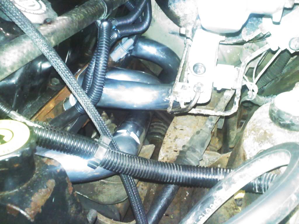

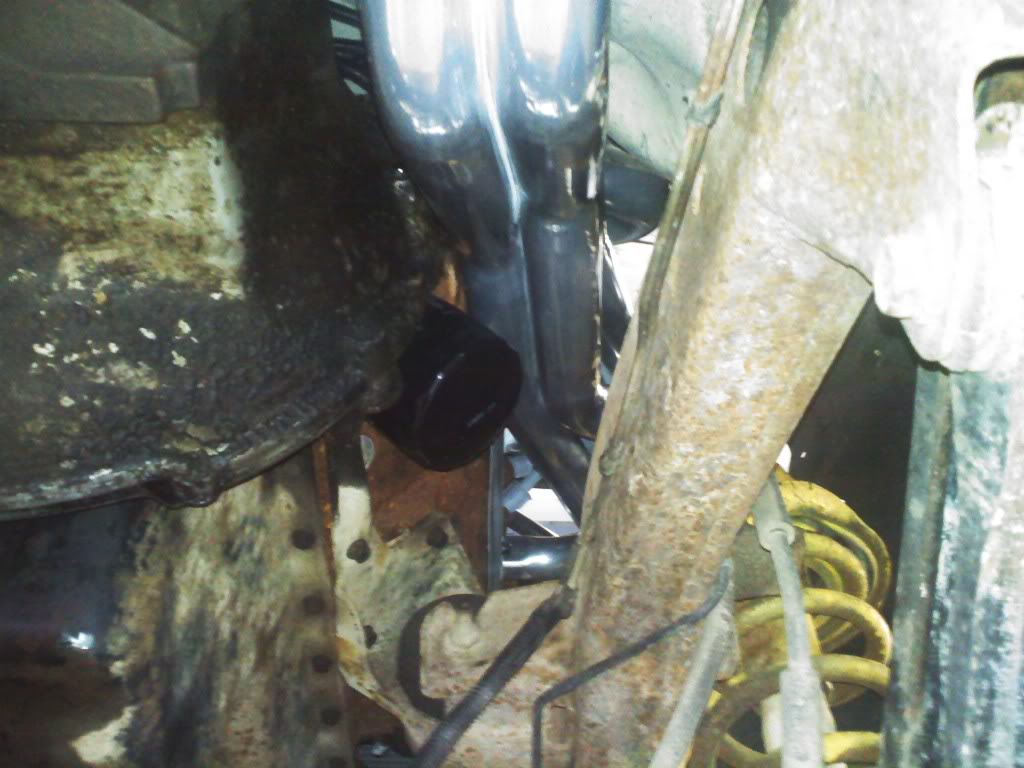

Hey everyone, figured I show some pictures of my install. I found of thread on here where someone bought a set of Pacesetter long tubes with the offroad Y pipe kit for their Ram 1500. I was so excited to see that someone found a longtube kit that I had to go for it. So, here they are, ceramic coated, 1 3/4 inch into 3 inch collectors with 3 inch Y pipe kit (I didn't take pictures of the Y pipes on). I was very nervous buying these because I have a 2500, and according to summit they would not fit a 2500. But, I went for it, and there you have it, they fit! Sounds amazing, almost like a monster truck when I just had the open headers. The Y pipe barely cuts down on the loudness, but it will be better once I finish the exhaust with a set of mufflers. Installing the drivers side was a huge hassle, had to remove the master cylinder, wires and harness in the way, the front drive shaft, and the starter to be able to squeeze it in there. I almost gave up at one point, I figured my loss, summit was right, 1500 only...but I gave it on last push and twist from under the truck and it basically fell into place. It did scratch the ceramic coating a bit but nothing deep enough to worry about. The only issue I'm having is that the front drive shaft rubs on them. With the truck on the ground I can spin the shaft by hand and it just barely rubs the pipes. I'm also worried about heat damaging parts under the hood (brake lines, plug wires), so I'm probably going to fabricate some heat shields to protect stuff. I was going to try using a hammer to slightly dent the pipe by the drive shaft to give it clearence, but I'm afraid of damaging the ceramic coating. Anyways, so far I'm super happy with the product, throttle response is increased, but I haven't driven it far due to there being no mufflers yet. Enjoy!

They look about the cleanest piece on the vehicle so far looks good though, but dang thats way to close to the shaft IMO, ive seen a few other pics of longtubes that are close but i dont think that close, gonna pass on the longtubes myself....

You know the first time you hit a bump in that your driveshaft is going to smack that header right?

I was thinking what if he goes offroad and flexes it
Yeah I would really suggest a leveling kit.
