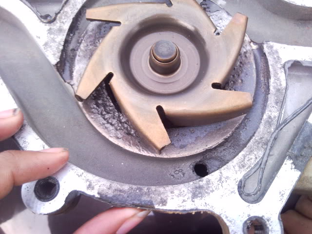

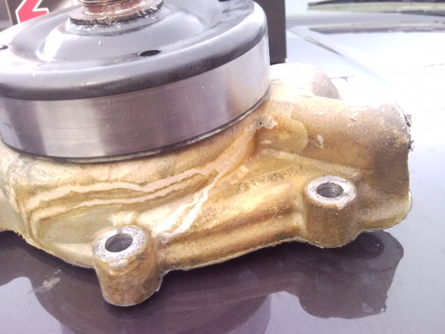

well finally got it off! and new one on!!!!! could someone tell me how this could have happened??

It just the age of the water pump. after a while of using it, the bearings start to go south and it no longer works. the main way to tell if you WP is shot is to see if it's leaking fluid threw the weep hole installed by the manufacturer. glade to hear you got it fixed. while you have it off, change the bypass hose and grind the "front" tab off of the T-stat housing.

That tiny little hole is the weep hole? You might want to flush and chage your coolant , If you havent already, some ppl not saying you , but i heard if you mix exteneded life with green , it causes a reaction and eats away at the cooling system

I had a leak on my 360 6 months ago and could not see where it was comming from either. So I did the whole water pump replacement thing. Now here I am 6 months later with the the front of my engin torn off again to include the timing chain cover. All this time the gasket was bad between the block and the timing chain cover. The water pump was cashed anyway but I wish I had change the T chain gasket then.
I would strongly recommend raplacing the T chain gasket BEFORE you put the water pump back on. I am betting that is where your leak is. If you dont do this I guaranty it will still leak when the system is pressureized.
