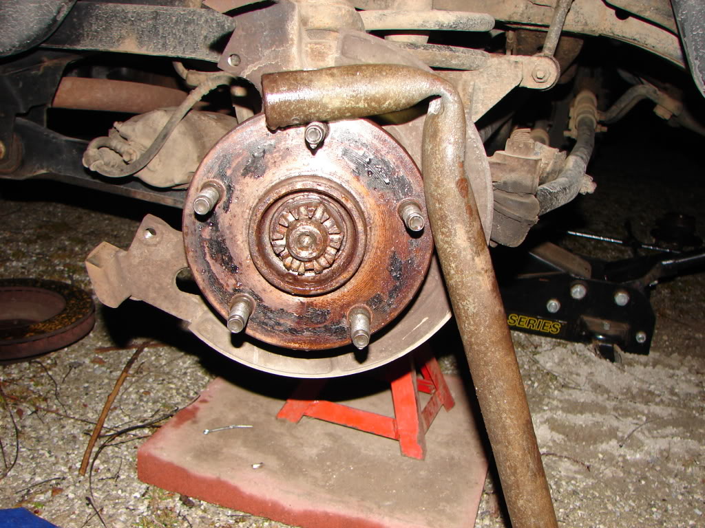

I'm working on my axle nut now - how do you keep the passenger side axle from turning? Is it okay to engage the 4x4 to torque against? Or do you have to leave the calipers on and stand on the brakes?

Look at the picture on post #11, see the pry bar jammed in the vents on the rotor, it is resting against the caliper bracket (just two bolts to put it back on) and that kept it still.

Holy nuts it worked! Thanks man!
