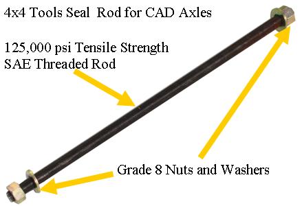

Has anyone made this tool? can someone take a quick pic for me what it looks like? i think I have a general idea what it should look like.

http://quad4x4.com/Front%20Axle%20Sh...al%20Tools.htm This site has pics of the tool you need to make.

Is this really it? this was not what I was thinking lol
where does the socket come into play?

As far as the axle seal goes, space in the cad unit is very limited and the seal is in the passenger side of the axle tube when looking at the cat unit. So a big piece of pipe (or a broom handle) would work fine for popping the old one out but you need a seal driver to install the new one from the outside of the axle.
I went to a hardware store and got some washers that were the same diameter as the seal and used that to drive the new one in. My setup was the same as the picture you posted, I used a 5lb sledge hammer head (minus the handle) as the hammer part of the slide hammer. I also wrapped some masking tape around the threads on the end of the threaded rod that was going through the seal to prevent any possible damage.
I kept the washer centered on the seal in the cad unit while my dad hit the other end of the home made slide hammer when I told him to.
