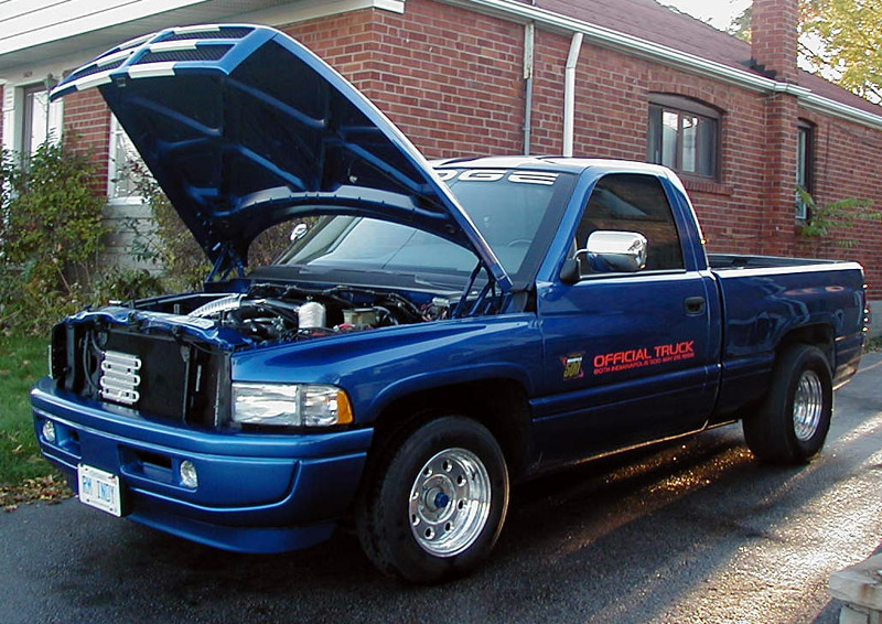

From: Ontario Canada
Ran the www.ramairbox.com setup for 5yrs prior to adding the Procharger. That ramairbox is the best setup available next to running boost. The alum ducts are the prefered method due to the ridges not being as high & you can compress them so they are essentially smooth inside compared to the rubber ones in the pic that Max posted.
My Indy, 5.9/3.92grs @ 70mph I saw .5-.75lbs of boost on my vac/boost gauge.
Prior to installing it I was using an open 14x2.25" K&N (original K&N fipk for genIIs). Instead of using the 14x3" thats needed for the ramairbox I just used the 2.25" tall filter. Even with the smaller filter than recommended & not sealed that great I still managed to see a .2 et reduction. (was running 14.35-14.5s prior)
With it sealed up better, ducted from the bumpers & adding some efans. Managed to run a 13.99 (fans only gave .08 off ets). Not bad for a stock 5.9 from tb down.
Later on I added the proper 14x3" tall filter & got it sealed much better. Figure I gained another .15 though never confirmed it. (other changes before I got back to the track)
Compared to a stock airbox/filter probably good for .55sec I figured in et reduction.
Most Dak RTs that added them back then (late 90/early 00s) were seeing at least .6 off ets.

Indy nice truck!! Do you need to have an electric fan installed to run the duct work through the bumper?
