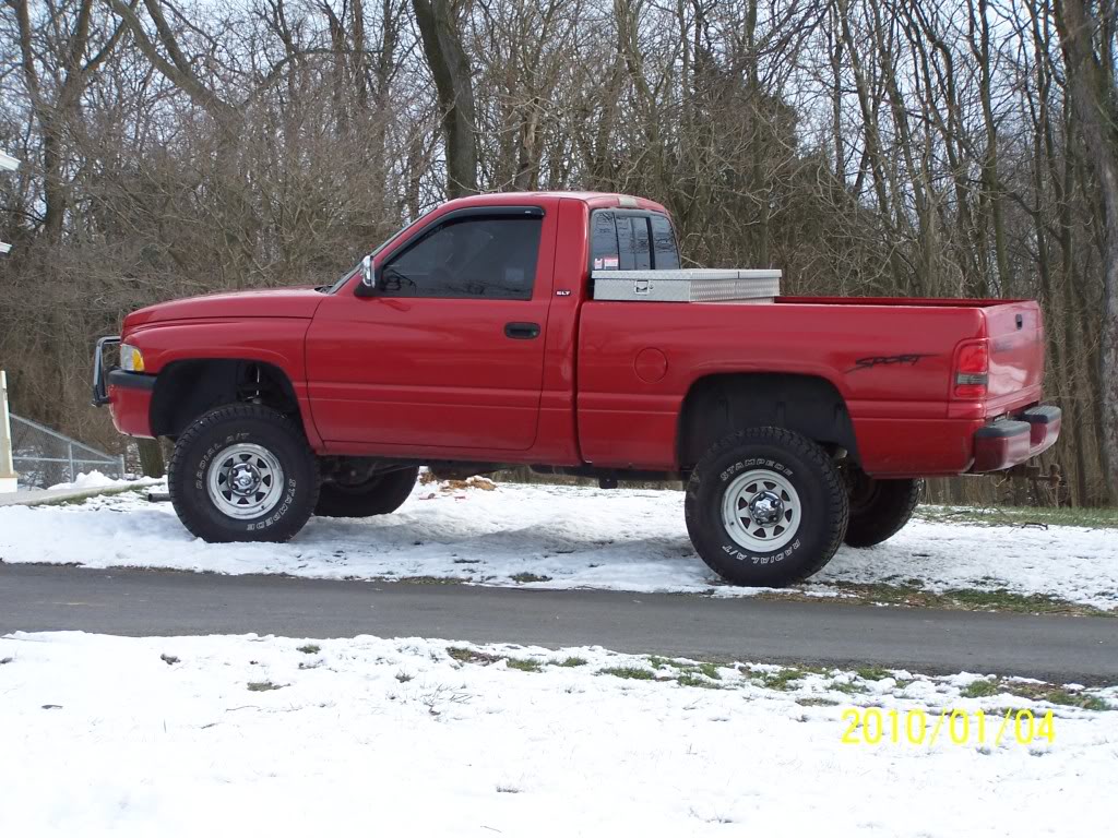

I used a heat gun and some fishin line, came off nice and easy.
