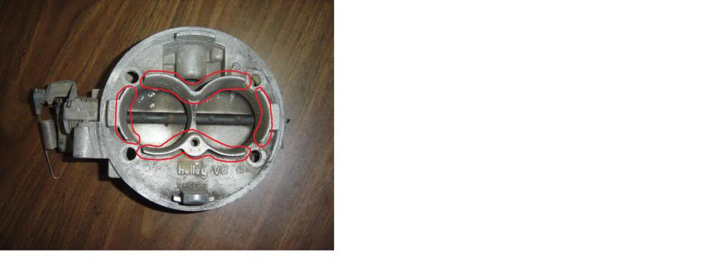

at the least cut or air horns(free)
https://dodgeforum.com/forum/2nd-gen...or-man-tb.html

what do you mean by cut or airhorns?
Old May 6, 2010 | 11:50 PM
dodgeram07's Avatar
dodgeram07
Joined: Mar 2008
Posts: 3,363
From: ohio
in red
