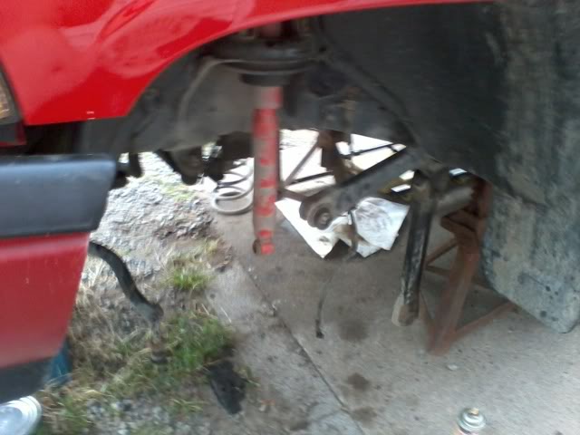

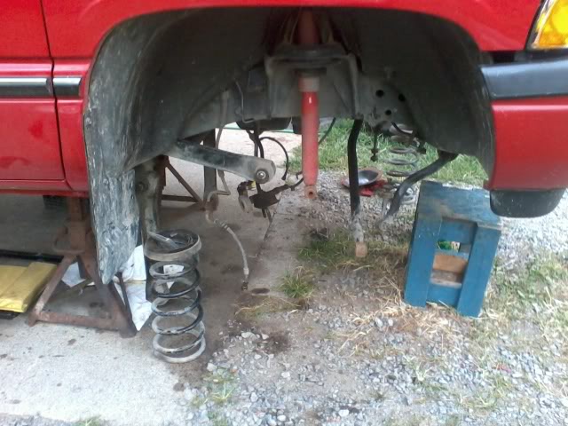

Finally got it out

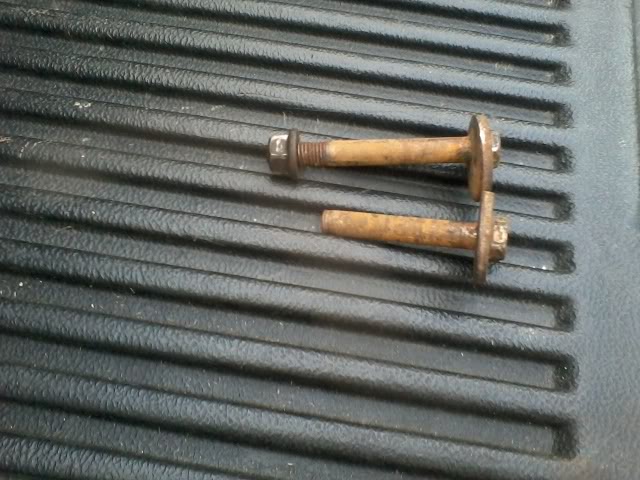

Now this is the bolt I broke does any one know where I can get a new one it goes on the lower control arms

You can try the parts store, but, don't hold your breath. Best bet is probably the dealer. They should want less than a hundred bucks for it......
Cam Bolt. Used for aligning the front end.
That's a big hole under the front of your truck.
