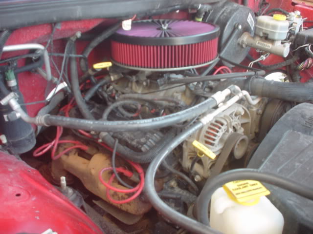

Also there is a ground connection in the top left hand corner of my engine bay near the PCM. There are 3 grounds but only 2 are connected to something. Ill take a pic as soon as I get out of class. Does any body have an idea where that ground should go?

and the ground prolly goes to the back of the head?

As for the ground, you said the back of the head. Can you give me a little more details about the location.

this is not my truck but the grounds I am talking about are in the pic. To the left of his filter bolted to the firewall. Name:  tomsstuff008.jpg

check the back end of your valvecovers, there should be a ground strap to one of the vc bolts I believe

Yeah the valve cover gaskets were replaced, so thats probably it. But here are some pics of the grounds that are loose. This is not to the alternator or the compressor. Idk what it goes to.

the first pic goes to the passenger side rear on the valvecover bolt.
The second one goes on a bolt that goes into the drivers side head. If you follow that cable down in between the head/intake valley, it will go somewhere on the front of the engine in a bolt that foes into the head.
