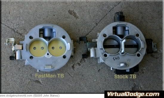

you could also do a fastman for throttle responce or make your own if you have access to a milling mashine to remove the walls on the throttle body from blocking air to go into the intake manifold. fastman bores out the throttle body , but just taking off the walls would help for a cheaper route Name:  wm_normal_255837.jpg
