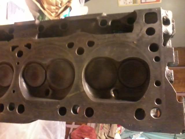

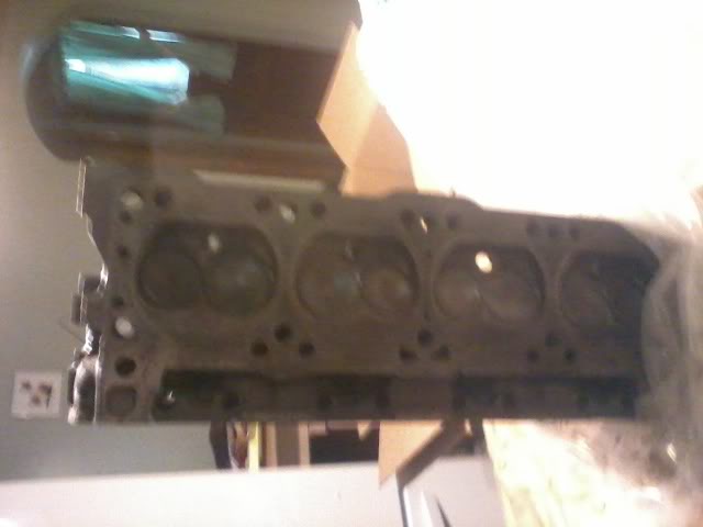

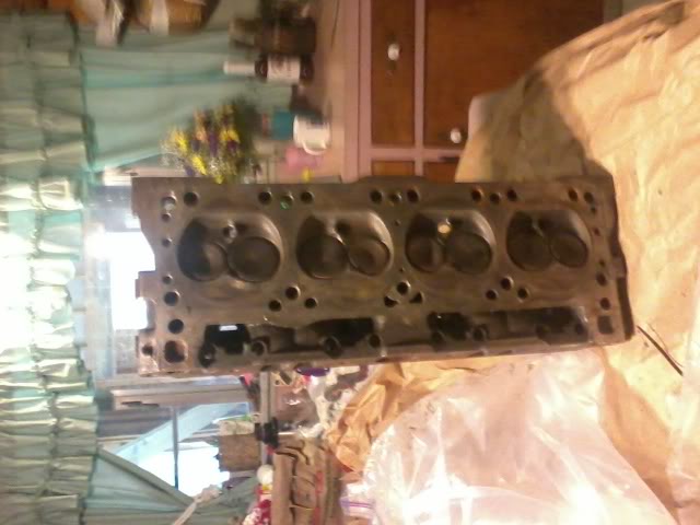

Got the heads today sorry the pictures suck so bad only had a cell phone.

Nice dude, so when you gonna slap these suckers on??

I found a set of stainless valves for 100 bucks so I think I am going to buy a set of them new springs and have the heads gone over befor I put them in. Because I am also doing a cam soon.

Double check the size of the valves before you order, some R/T heads came with 2.02 valves, IIRC.
You can check with a set of dial calipers.

I thought all RT heads came with 2.02 valves.
Yeah, they don't flow much better than stock. I plan on getting the Iron Ram heads. After that i am done with the engine. But before I get the heads, i am getting the 4 wheel disc brake upgrade. Then a front rotor upgrade.
