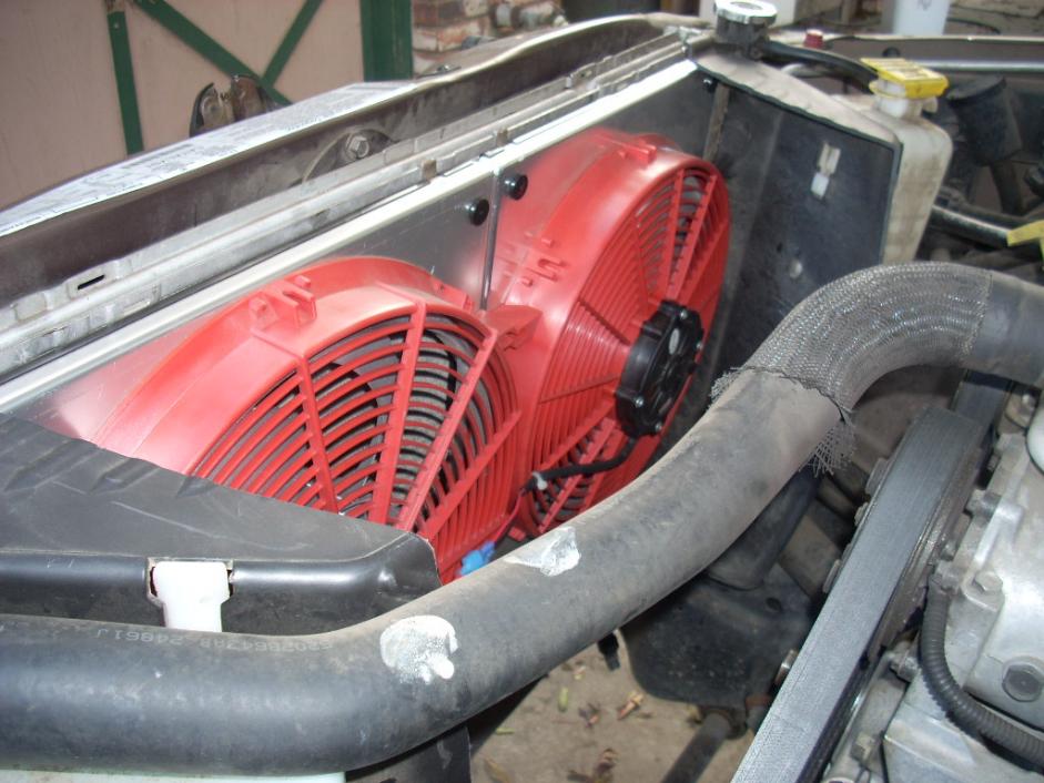

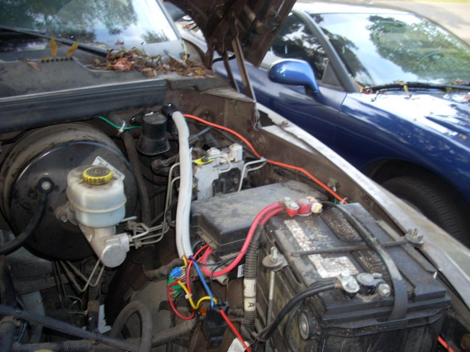

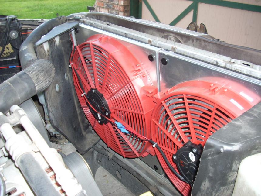

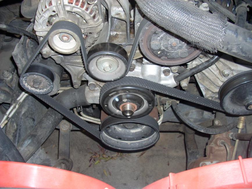

Well here they are, at the highest setting on the thermostate, I am running about 10 degrees cooler. The aluminium shroud adds to the cooling for extreme areas. And in pic 3 look how much room you have to work on the engine.

the aluminium parts are not plates they are shrouds & they come with the fans ready to go.

It looks good dodgedude. Is this the Ultra extreme kit?

yes, custom utra extreme
