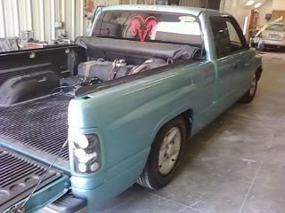

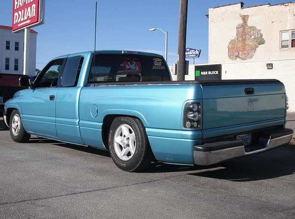

pics:
Those are some teasers until i get some new photos of it
