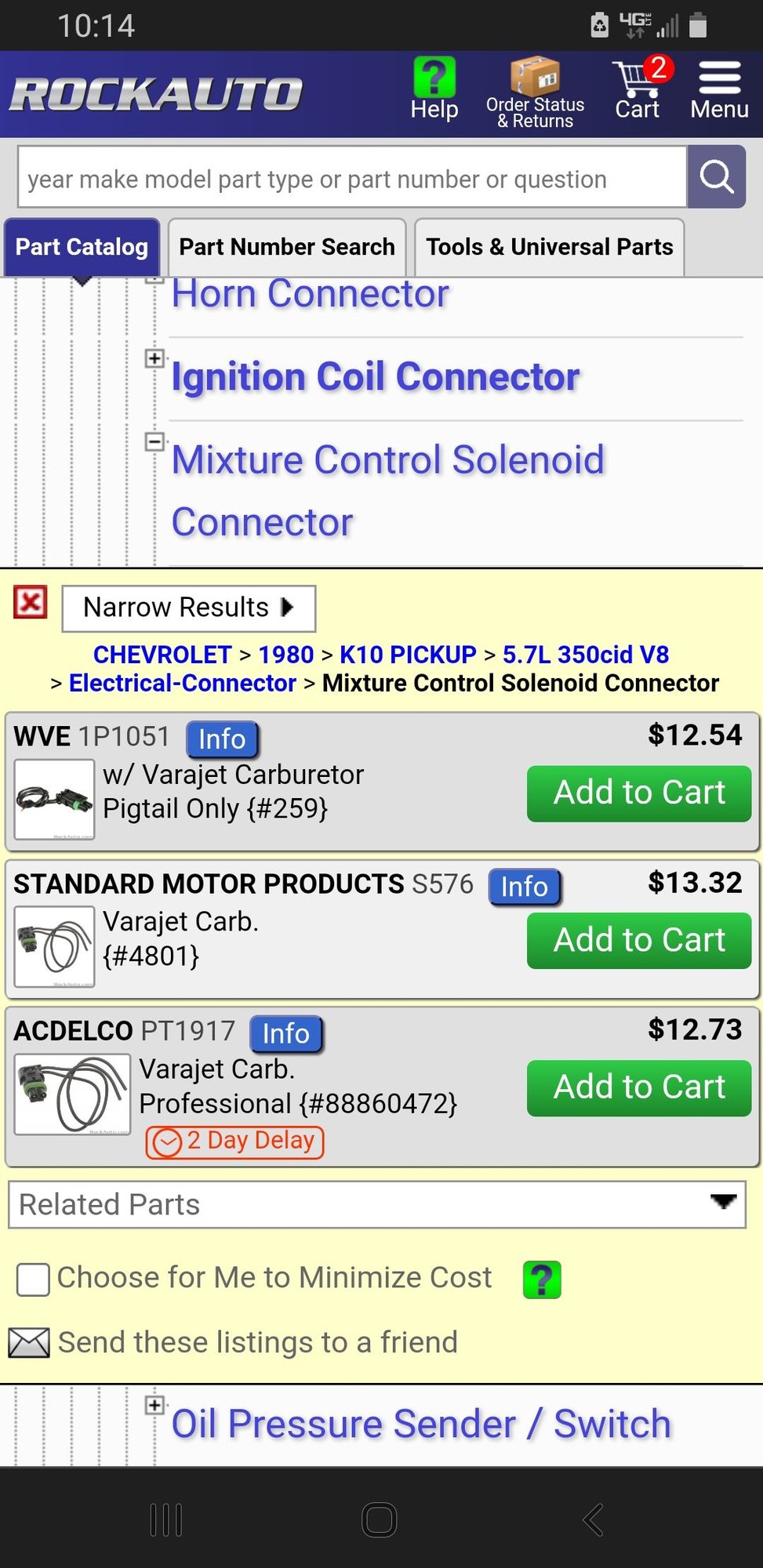

Originally Posted by 00t444e
I would permanently lock the cad then if you need the 4x4 light to work I believe you could screw a switch in for a Jeep or Dakota where the vacuum switch is on yours. I have 2 Jeep transfer cases and a Dodge NP231 sitting in the shed I am going to test this on but I keep forgetting.
I found this last night. The switch is a Dorman part # so use retailer of your choice.
He links to a DuraLast (ie AZ house brand) solenoid connector and I was unimpressed with $20. However through some sleuthing AZ's site will hint at what vehicles that came on (their part # alone didn't help me with interchange).
One option (of many) would be a 1980 square body GM, so I put that into RA, scrolled thru electrical connectors and the first solenoid connector i came across (for "mixture control" for a "varajet carb") looked identical. This at least got me options closer to $12-15

Possible connectors
