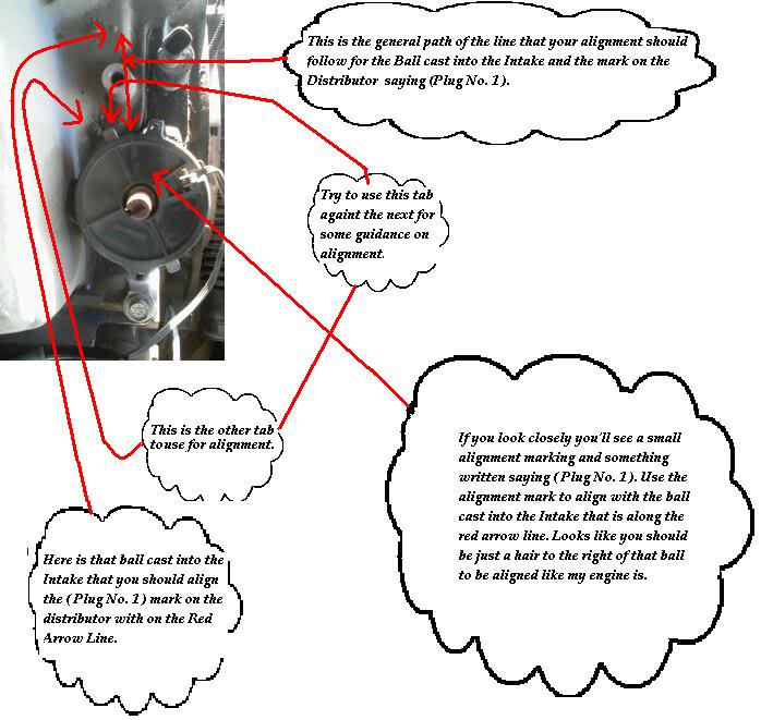

I suppose it could be 180 out. And here is a good pic of how to install it, courtesy of Slomojo

Ah yes, 180* off! Took the dist out, rotated the crank 180, lined up # 1 cylinder, and 2nd crank......It came to life!!!
