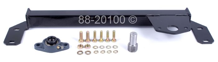

well i was talkin about the thing that tired the front two frame rails together http://www.carsteering.com/Ebay/ebay...P/88-20100.jpg

I don't really know if that would be required for our trucks..... I could see if you were running some fairly large meats, that bracing the box wouldn't be a bad plan..... Not sure if the dodges have the frame cracking issue that the chevy's did.
What size tires ya got on your truck? Do you have steering issues?

They mainly keep the pitman shaft from wobbling all over the place. http://www.genosgarage.com/prodinfo....ber=BD-1032004

i have 315-70-17 guard dog treadwrights and i figured it would help the steering. i thinkin about getttin one of those or dual steerring stabilizers

Bump steer. Neither symptom really indicates a problem though, fairly standard with big tires. An alignment might help some, but, I wouldn't hold out a lot of hope. The brace may also help, to an extent, but, don't expect to completely eliminate either condition.

alright then i was thinkin about trying it cause i can get one for around 80 dollars
