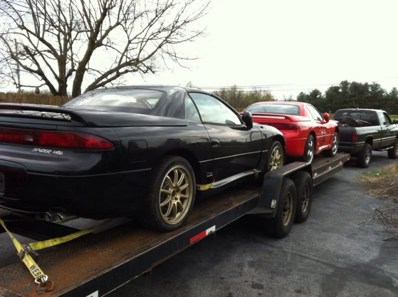

New load. 2 95 3000gt Spyders. Engine bay of the red one is in the bed of the truck along with 2 sets of wheels. This is definitely the heaviest load yet. Cruising home at 55mph. Good thing it should only take 5 hours.
