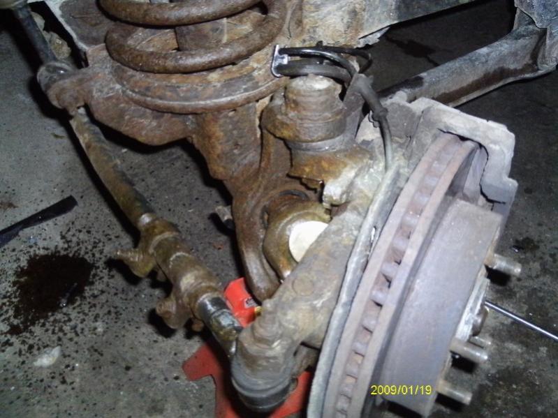

Need some help in the front end of my 2000
hey all.. 2000 1500 sport, 5.9 4x4.
I got real caught up in other spots of the truck, tranny, waterpump, u-joints, ect ect... that the front end has really gotten out of control...
My wheel bearings are shot, front joints are gone, and I am trying to figure out what else..,
I Do have a manual, but cant make any sence of this thing, I am by NO MEANS an axle person.. So i am learning on the fly here...

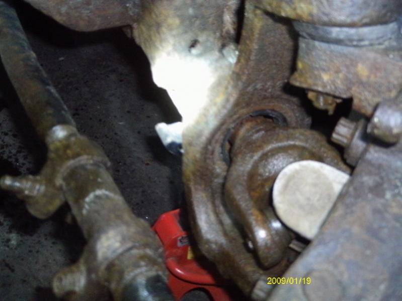

In these pictures, Is there supposed to be a bearing or something behind the u-joint on the front axle?? if there is supposed to be, then mine is toast...
Does that part hold oil? big deal?? I just need to find out what goes there so I can replace it.
Thanks all.

Looks like the axle seal is leaking.... which is a drag, as on the drivers side, you need to remove the carrier to change it. Yeah, **** poor design idea there.......
I don't think there is a bearing there, what you are looking at is just the 'slinger', it is supposed to keep the rude stuff out of the axle tube, but, doesn't do a very good job, what it DOES do, is a good job of trapping whatever manages to get in there, IN there......
Most of the tube does not hold any oil. At least, not by design.......
Your best bet, since you are looking at digging pretty deep in there anyway..... pick up new hub/bearing assemblies, u-joints, axle seals, and ball joints. (and whatever steering parts you feel need replacement.) set aside a couple days for the job, and do it all up.

You'll be fine. If you've done all that other work you've listed, you should be able to handle this. Yes you have to take gears out to change the driver side seal, but really it's not that bad since there are no shims to lose. There's a good DIY page out there with pics if you search for it.
