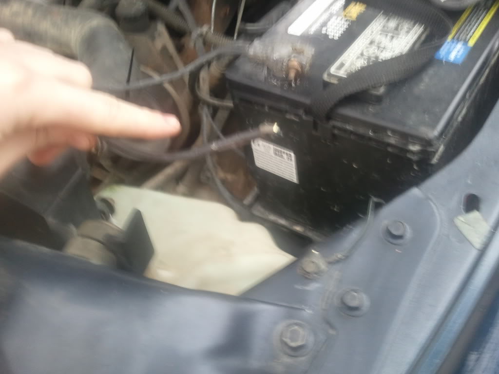

this was the problem lol easy to find in the daylight...
here is my working gauges again i liked it before when my truck made its own gas lol
