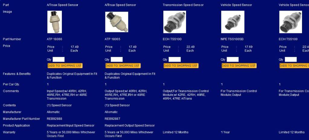

maybe this helps?
Old Jan 6, 2011 | 10:15 AM

OK, I ordered these, they the right ones maybe?
http://shop.advanceautoparts.com/web..._1444139463___
http://shop.advanceautoparts.com/web...___#fragment-1
